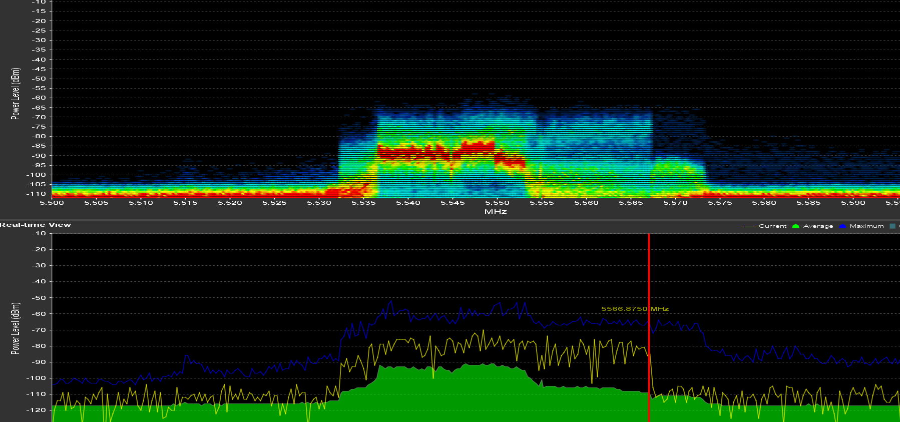

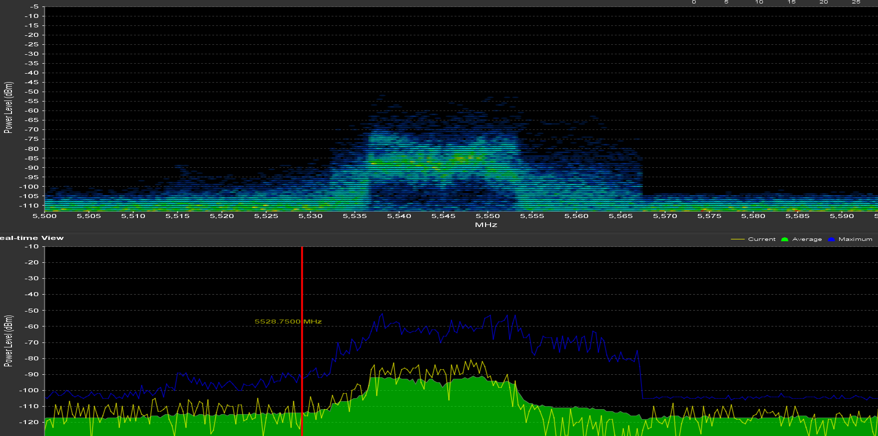

So to figure this one out ourselves; we fired up airview, set up two new sxt’s and tested. Centre frequency for the test is 5545mhz
You can see in the file 20mhz; centre frequency is clearly 5545mhz although there is a concerning amount of bleed either side of the centre frequency.
In the file 40mhz you can clearly see that an additional 20mhz channel has been tacked on as well as a considerable (10mhz) amount of bleed in the upper frequency. This doesn’t not appear to have shifted the centre frequncy; and the additional channel appears to be detected at a slightly lower power level than the control channel.
So not only is the channel detected as being a lot wider than 40mhz; it does not appear to create a new centre frequency as you stated.
Of course; i would be happy to hear other interpretations of these attachments.

I think the pictures above paint a clear picture that extension channels dont work the way most people assume them to work, the channel chosen in ROS with an extension channel above ends up being -10mhz to +30mhz from the channel chosen and reverse for extension channel below, This is counter to what resources online point it to be. The manual doesn’t explain this behavior and as such can’t be incorrect but it’s a failure of MT to explain this behavior when it’s very different to the behavior that clients using turbo mode are used to and difficult to diagnose without a spectrum analyzer
Well, I don’t know what you call a “centre frequency”. I would call it the middle of the frequency range of the bandwidth the radio transmits in. So if you widen the band upwards, the centre frequency travels with it upwards. (half as far). Your pictures are showing this perfectly. Take the upper limit and the down limit of the 40Mhz channel and you find the new ´centre frequency’.
That now this 20Mhz extension might have some slightly lower power as the original chosen 20Mhz band has nothing to do with it. (Although it is interesting to see!)
That MT in its ROS still uses the original centre frequency of the first chosen 20Mhz band is merely an approach of them.
You might find this confusing. Maybe pure mathematically it would be better to show the new 40Mhz centre frequency. I think it is also some resemblance of how they used same in older ROS versions.
´Bleeding´ of radio energy outside the set working frequency’s limits is nothing abnormal. Plenty is written about that in this forum. EVERY radio bleeds outside its working band. It is merely how much the bleeding is that distinguish between poor radio’s and good radio’s. (Or capping filters in use.)
No hard feelings but I’m sorry to say that my interpretation of your pictures are more proof to exactly what MT means in their manual and I see happening in real live and what makes sense if taken it mathematically.
Your interpretation has some ground, but not as much as mine.
It is also not a big issue. You are the first I ever see mentioning this issue while there must be plenty of operators using the extension channel for years now and they exactly know what they are up to. If there were any ´real´ issues on the extension channel I’m sure it would make it to this forum many times before you did.
