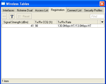

Being extremely new to 802.11N, I wanted to know if the performance results that I have been getting are about normal. Attached is a copy of my current wireless table. As you can see, I’m getting 130Mbps-HT on Tx, but only 13 Mbps-HT on Rx which seems a little low considering I get 52/52 Mbps on a standard R52H. I have a RB433AH, using the standard Routerboard RB433 enclosure, with two Dual-Band 2.4/5 Ghz antennas. Also, if anyone can point out settings that might improve performance, please feel free to do so.
Thanks,
-tp
