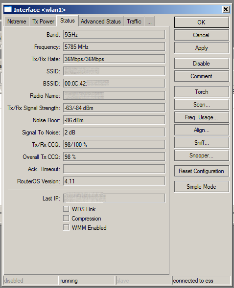

As far as I can tell it’s not a card issue. Purchased two additional cards, swapped the radios out individually on both ends of the link. Issues persisted no matter what card pairs were in the link. However, was able to stabilize the link by doing the following:
Setting the cards to 802.11a-only mode.
Limiting modulation to a maximum of 36mbit on both ends of the link
Ignoring radio card’s eeprom transmit power config and setting the card to use 22dBm at all modulations.
Setting hardware retries value to 10.
Signal strength readings are still quite wonky. The client sees -84 dBm signal, transmits at -63dBm and a noise floor of -85 dBm. Despite the apparent 1 dB SNR radio the radio still works properly at 36mbit both directions – get ~25 mbit TCP throughput unidirectional, ~11 mbit TCP throughput bidirectional. CCQ stays at ~100%. (See attached screenshot.) The AP sees a noise floor or -108 dBm and the same signal values but in the opposite direction.
I have double-checked, system is using the latest routerboard image and OS and should not be running out of date firmware for these cards. Has anyone seen signal level issues like this that were not caused by bad hardware? Thanks in advance.
