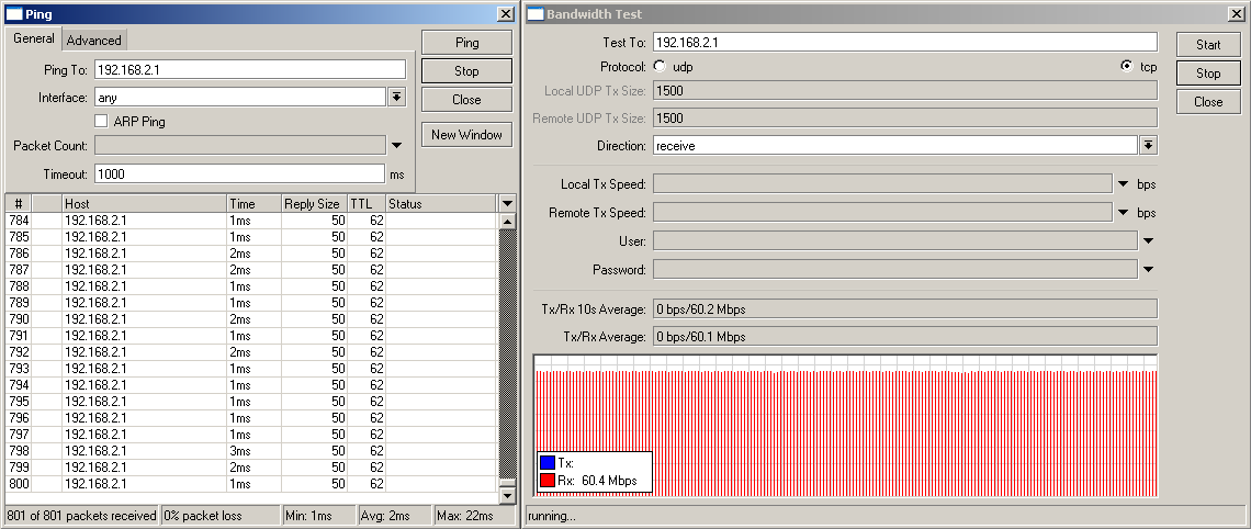

Pics of my testing
well these results are bad. 50 Mbps? no good for N
Okay…

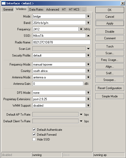

After a day or so of messing about I’ve gotten the following results…(thanks to omega-00 for the excellent information)
[w/ conn. track]
TCP: 60.6MBps (peak) 60.1MBps (average) Very stable (w/ conn. track).
UDP: 179.8MBps (peak) Very unstable.
Ping Times - 1ms/2ms/22ms (min,avg,max)
[wo/ conn. track]
TCP: 64.5MBps (peak) 63.2MBps (average) Very stable (wo/ conn. track).
UDP: 196.7MBps (peak) approx. 165MBps (average) Stable.
CPU Usage approx 30-35% on Master Draft-N unit (bridge unit).
Ping Times - 1ms/1ms/8ms (min,avg,max)
Using 2x RB600A boards and TP-Link Draft-N cards.
Using 2x RB600A boards to generate traffic.
Very noisy environment. Scanning detects 5x APs in the building. One AP running 100mW about 10 inches from the one test board. Turning all this off makes no difference.

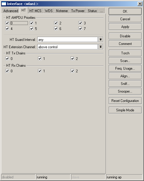

Channel: 2412 (other frequencies perform more poorly)
AMPDU: All selected on both units (definite bandwidth improvement)
HT Extension Channel: Above Control (definite bandwidth improvement)
HT TX/RX Chains: All selected on both units (definite bandwidth improvement).
These three changes upped the UDP bandwidth from 95MBps peak to 179.8MBps peak on UDP and from about 44MBps to 60MBps on TCP (stable). Disabling connection tracking boosts the TCP average by about 3MBps and makes UDP more stable with the peak improving by about 20MBps.
Tried various other settings, but none made a difference (except to possibly worsen it)
Will keep fiddling.
