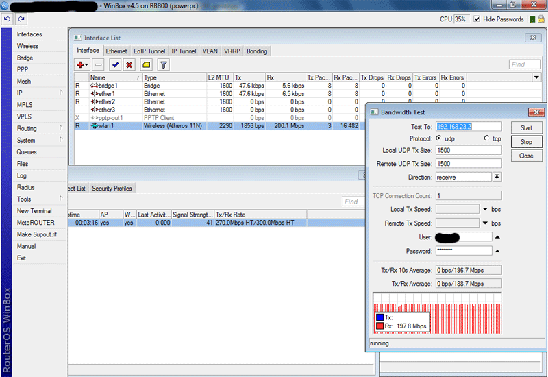

Here it is again:
but this is utp trafficâŚ
can you send a picture of tcp troughput??
tnx
bye
YesâŚ
Here is the real traffic, downloading from rapidshare:

with 433ah you cannot achieve this..
You should not use x86 PC because there is hardware incompatibility with some motherboards .. You should use mbs which is proven to work good with mikrotik and upgrade your bios to the latest version.
Use RB800 on both parts of the link and you should not have any problem.
Configuration is exactly like in this thread.

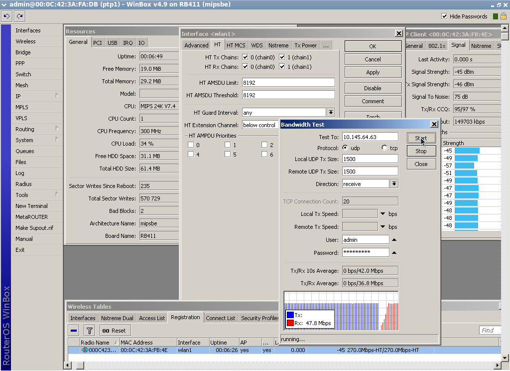

I am testing two RB411 now in bridge and canât get 200 Mbit UDP which I achieved about year ago with bridge with RB600A and RB433AH maybe at that time routeros 4.2.
Current setting and condition:
- indoor test
- Two RB411 with R52N, routeros 4.9
- bridge, WDS, 5 GHz-n, hw. retries 3
- signal is good, CCQ is good and stable over 90%
- link speed is i 270 Mbit HT and estimated P throughput is 150 Mbit
- 300 MHz CPU is not overloaded, usage about 30 % caused partly by test itself
- routeros UDP test goes up to 47 Mbit, speedtest.net mini measured 37 Mbit TCP
Why max. real UDP throughput is only 50 Mbit then it should be 200 Mbit?
Is this some limit of RB411 even CPU is not loaded too much?
Weird thing is that link speed canât get to 300 Mbit HT, only 270 HT even with good signal.
5GHz a mode real UDP throughput is 29 Mbit with good CCQ and 54/54 Mbit link speed, real TCP test using speedtest.net mini measure about 23 Mbit TCP
There should be some magic setting somewhere.
I have to buy another RB600A or other more powerfull board to repeat earlier tests and compare results.

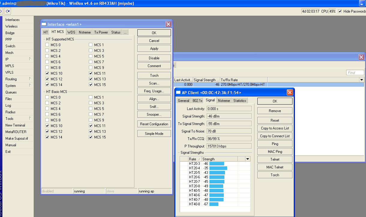

I have same issue with 270HT mbps. My link also never connect at 300HT/300HT. All time is connected on 270HT/270HT. Can anyone tell me whatâs wrong in my config?
Very Thanks.
Something is not OK.. My own experience is that 65mbit HW makes 60mbit thruput, 121mbit HW makes 95mbit thruput, as count as counting 270mbit has to make at least 210mbit thruput in layer2.. There is inter chain problem.. I will work this out next month
