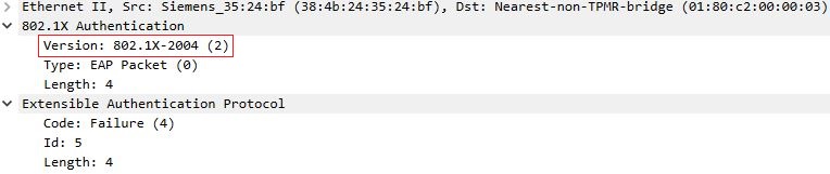

Now I have used a current Scalance XC200 and it no longer works.
The supplicant starts the authentication, the switch aborts, no packet is sent to the Radius server. The packet capture shows different protocol versions 802.1X-2001 (MT) and 802.1X-2004 (Siemens). The ROS version during the test was 6.49 and later 7.12. The MT versions of the protocol are identical and the results are identical(fail..).
