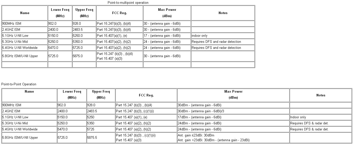

Here is a table that shows allowable frequencies and EIRP for Part15 equipment. This was put together by Kristian Hoffmann.
Thanks,
Chadd
