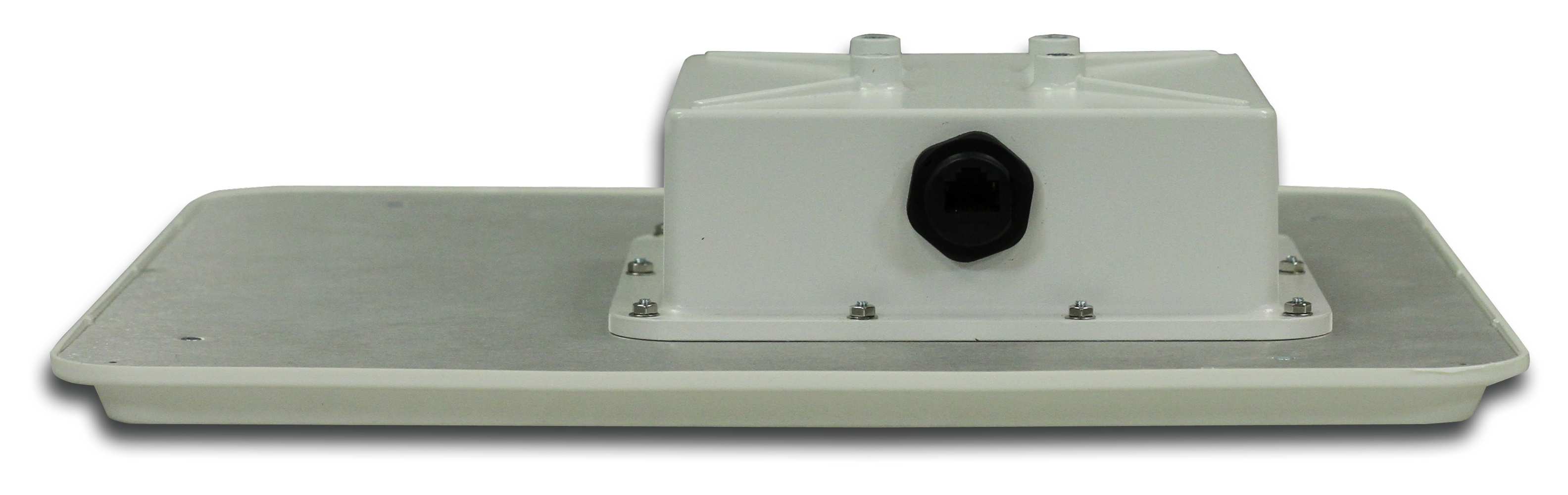

This is a SICE CPE with a panel antenna built like this : http://www.sicetelecom.it/wp-content/uploads/galleries/83/SICE_ATRH0591_CPE_5GHz_MIMO_TDMA_3.jpg (<-- website not reachable at the moment but should be soon).
Considered the position of the Ethernet connector, the RB911G-5HPacD should be mounted with the face up when looking at the back of the panel.
I am wondering if this is a heat issue, maybe leading to dilatation.
I live in Italy (center). During the day, at 6 am the sun will start hitting the antenna panel to the front. Temperature when sun is shining can range from 30 to 36 Celsius (depending on time of the day).
