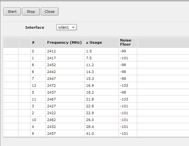

28+ WiFi networks on 2,4GHz. Are you suprised? Can you imagine 28 speakers in one room playing different music?

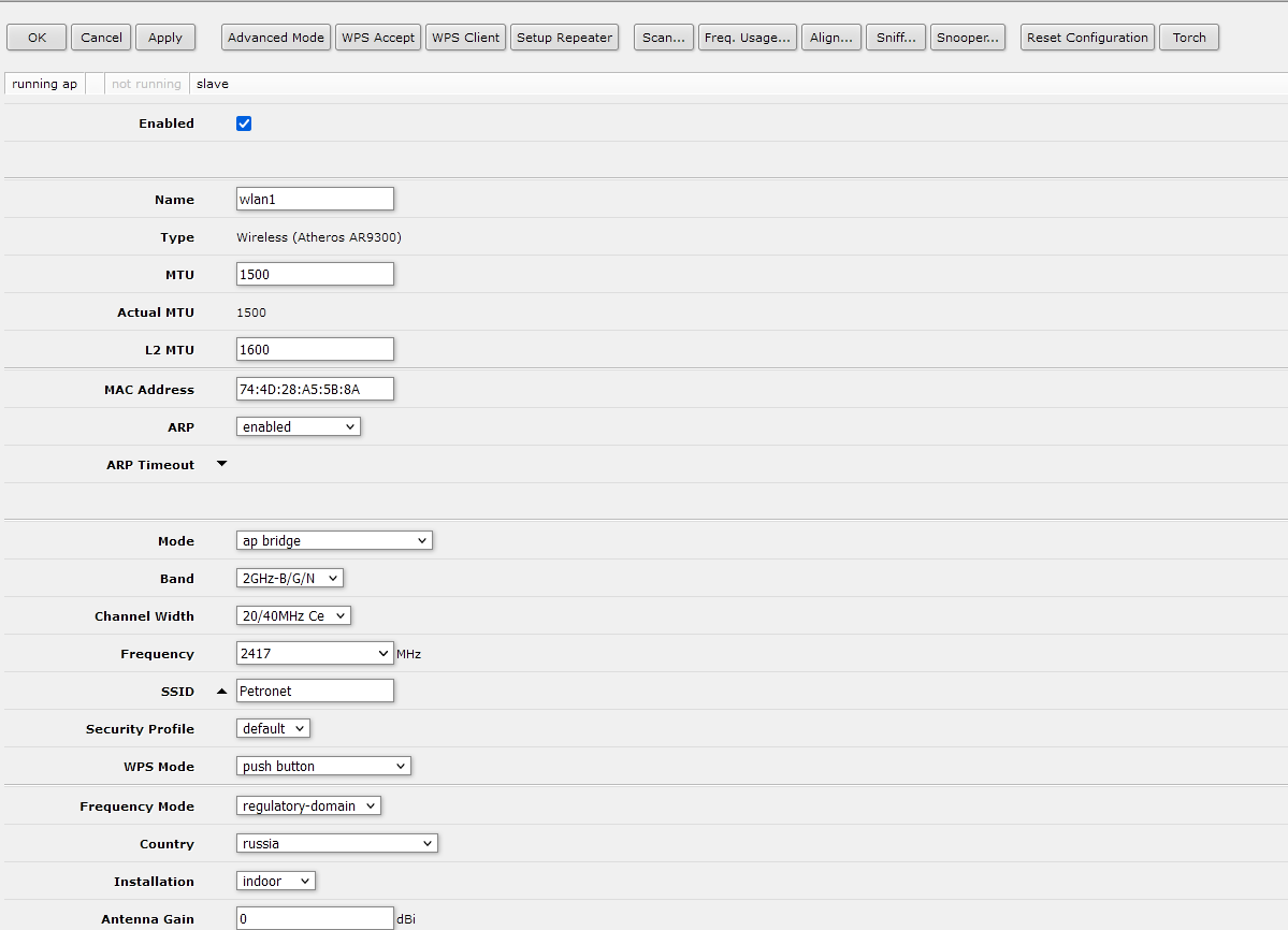

I recommend using Band 2Ghz-G/N to lower the channel width to 20mhz
try channels 2412, 2437, 2472 and choose the one that works best.
If you still don’t get decent results, and in very rare cases, use superchannel for extra power (Bad habits, sorry).

2: As @enlace101 said: stop using b-protocol (use g/n) , and only 20 MHz wide (no Ce, eC or XX) (Band and Channel width)

4: The top-5 in “scan” are the killing AP’s. -44dBm must be closeby or under your control. Item 1,3,4,5 are wide channel. 2 is on channel 13 and smaller. Those AP’s destroy each others transmissions due to wide channels. They could have used 2412/20, 2437/20, 2462/20 as 3 independent non-interfering channels.

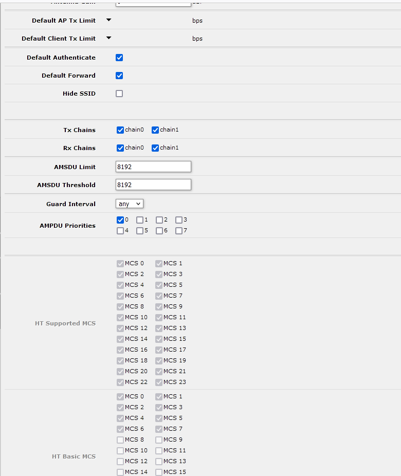

6. To avoid destructive interference, lower the packet size: AMSDU limit = 2048 , AMSDU Threshold = 2048. Or even test a lower value. But this will slow down the transmission as well.
