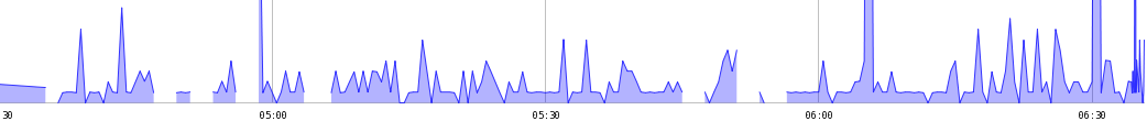

metal 9hpn drops registration for 1-2 minutes when noise goes from ~-113 to -97. Peculiar to note that it’s -97 every time; no more or less.
Occurs as often as every 5 minutes. sometimes not for +10 minutes.
Normal signal is ~-77. chnl width 20mhz.

When disconnect occurs, the noise on the Bridge unit goes to -97 dBm (exactly, and every time; no variation)
Tx/Rx is ~-78dBm on both units (i.e., sufficient overhead for some noise)
Also, attached recent log and screenshot showing disconnects.
