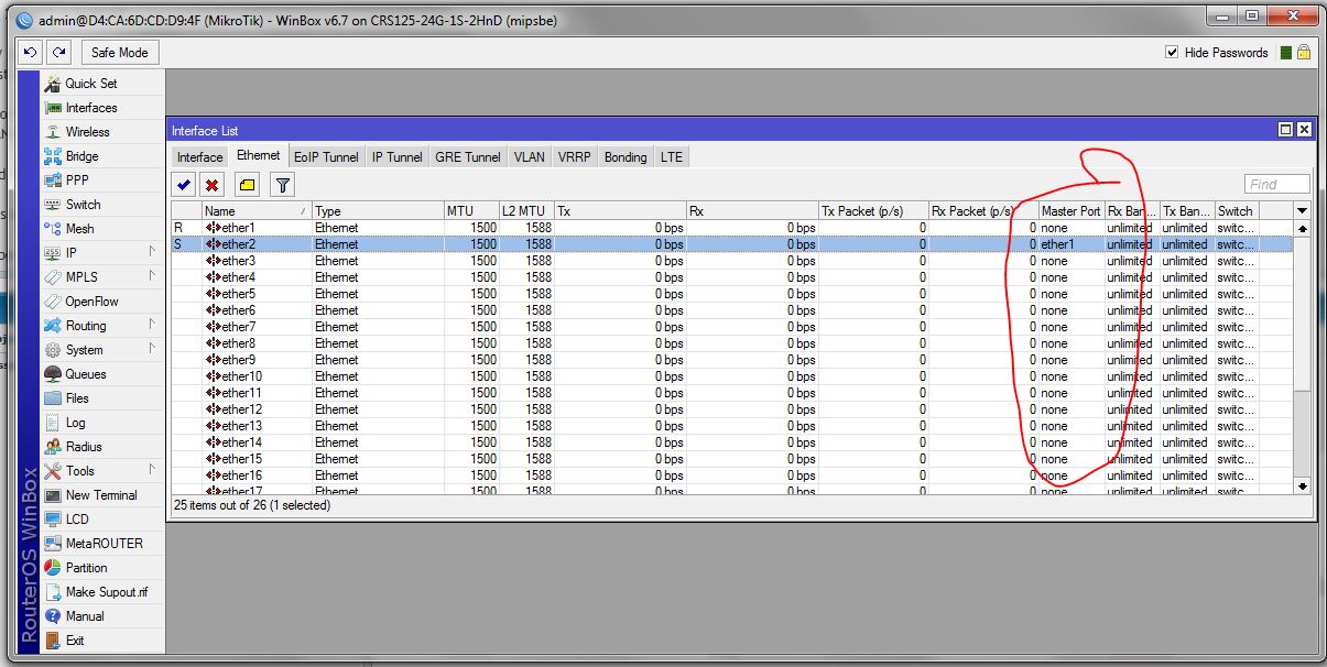

If so then I would use Mikrotik ether1 as your WAN and assign a usable address to it such as 203.171.1.1/24 to it. Note some ISP’s need a VLAN for Fibre so if you do simply add a vlan to ether1 and assign the WAN address to that.
Create a src-nat rule out-interface=ether1(or vlan) action=masquerade to NAT the hosts behind your Mikrotik.
Modify ether2 and set it’s master port = ether1. Now anything attached to ether2 is directly connected to the WAN in parallel to the Mikrotik as a switch.
Two things to note here.
  1. You say you have a CRS125, so be sure no other ports are in the same switch group (see picture) as ether1 & 2 .
  2. The reason we use a switch and not a bridge is ideally we want the traffic to not go through the Mikrotik CPU. If your Mikrotik did not have switch functionality (such as CCR1016 or CCR1036) you would have to use a bridge instead.
    This should let your ZyXEL connect for VoIP and the Mikrotik will also have internet access without needing a separate switch.

Now, I have (sorta) realized how i define “virtual switches” so to speak.
Does this mean that I could just use ether1-gw and then set ether2 to have ether1 as master and hook the zyxel 2812 there?
then set ether[4-8] to have ether3 as master and connect my “local” equipment there?
That would work :slight_smile:

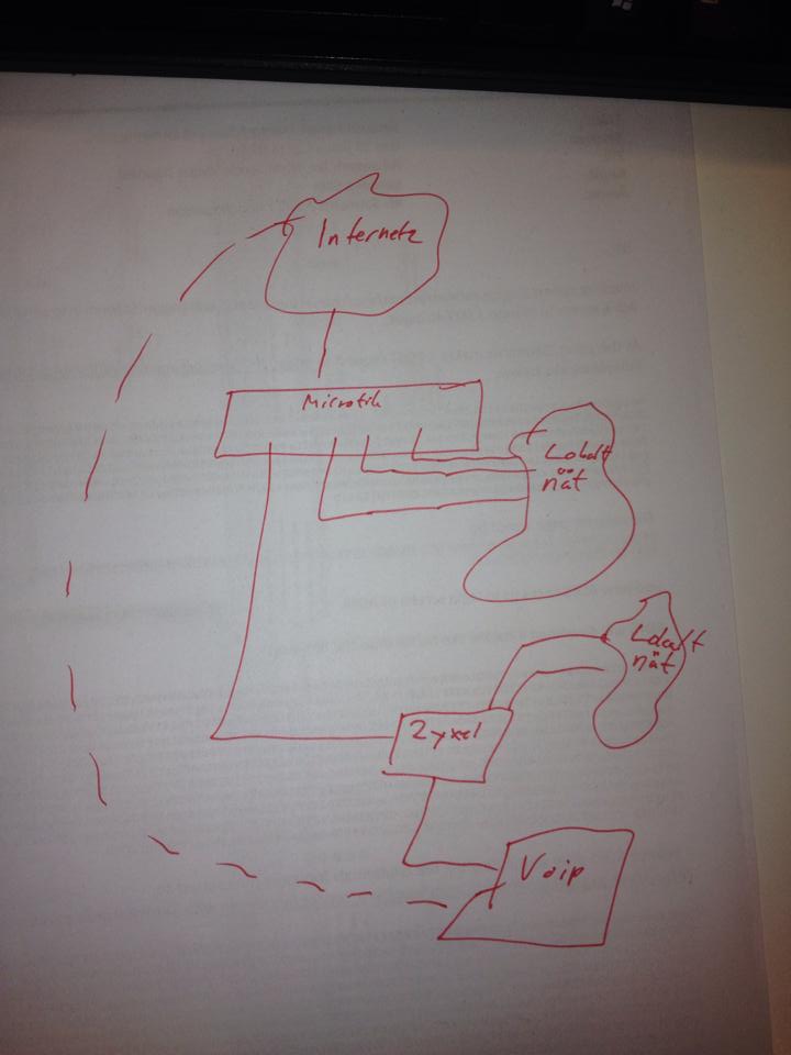

Ok, rebooting this question as the installation did not really occur as I had expected.
The scenario is the same, but the zyxel ata-adapter is no longer connected to the Mikrotik. I have a switch elsewhere in the house to which the ATA is connected.
In the attached drawing I want to obtain a setup which gives me the functionality of the “dashed line”. In other Words, i want the VOIP-adapter behind the zyxel switch (A Zyxel GS1900-8 but that should not really matter) to have a L2-connection to my internet provider.
Also, i want my “general local network” to be accessible on both switches?
So, how do i tackle this?
