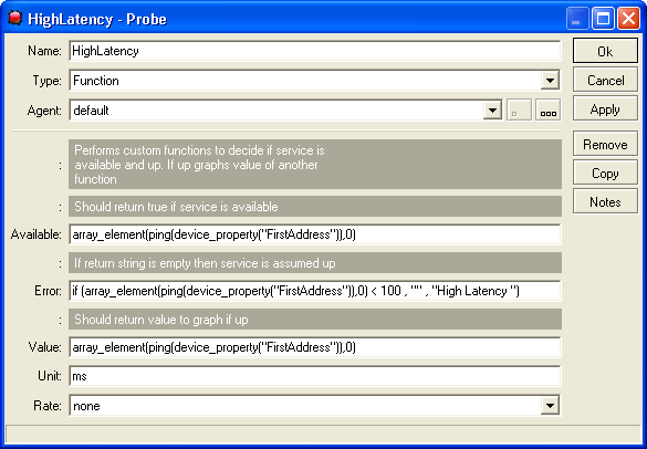

  1. is there a way to have warnings through the dude’s polling to send email when a ping gets high to a certain base? Say, 100+ms
I think you are going to have to stitch the map together, unless you have access to satellite maps somewhere. Check your local government GIS? You could make a top map that just shows the connections between each location with a sub map for each location. Then you can have a map of only that city.
I here is a probe that complains when pings are high…
There might be a better way to do it.
Thanks a lot for that, Sweetdude, it’s working perfectly.
