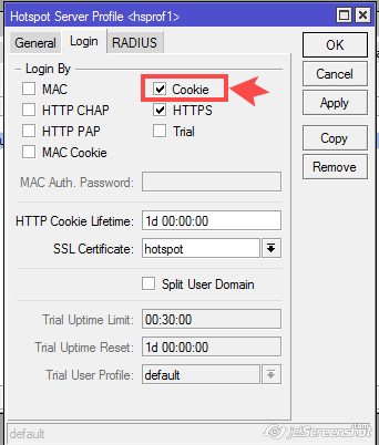

Can you watch video ? and Is this http cookie? ( for attachment picture)

  1. Cookie option is for different purpose, it has nothing to do with IP/MAC scanning software.
  2. At the moment HotSpot does not have any option to check unique secret key. For HotSpot server, legitimate user A with IP address x.x.x.x and MAC-address yy:yy:yy:yy:yy:yy, is the same as “bad” user who uses the same IP address x.x.x.x and MAC-address yy:yy:yy:yy:yy:yy:yy
  3. When you have network with “bad” users, that are using IP/MAC scanning software. The main rule is protect/control their access to local network, then netctut and other IP/MAC softwares will be useful.

Yes, because from router point of view, randomly generated IP/MAC is the same as for valid IP/MAC combination.
Yes, proper WPA configuration setup is enough to stop mac/ip scanning program in your network.

The same you can get with regular sniffer. Due to design and implementation of Ethernet, each person can get access to IP/MAC address by application (that is not specifically netcut). That’s why to protect from such situation, you need to invest 10-20 minutes to improve your setup to handle all bad users, that may take any valid IP/MAC combination from paying client.
