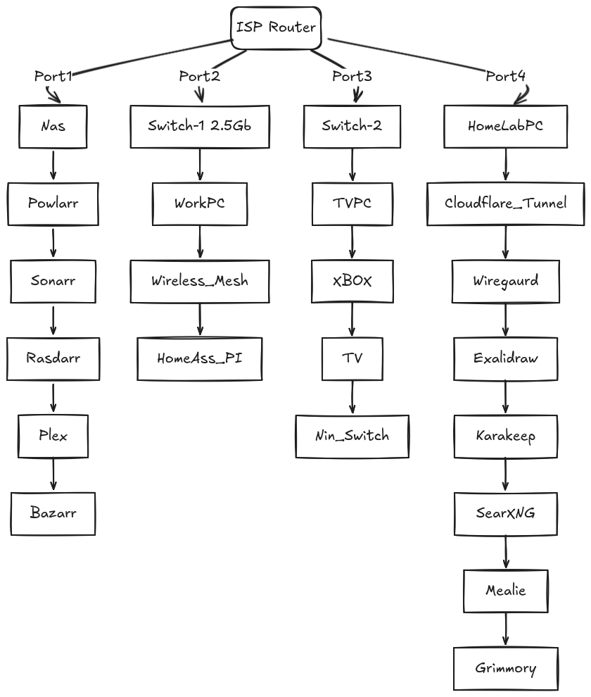

I bought a hEX S (2025) E60iUGS a week ago with the idea to gain more knowledge over networking.
I have created a simple image, with what I have now and I would like to ask for a lot of help.
Is here a good place for that, as I would like to script most of what I do. Not use the GUI.
As they will be some really dumb questions?
My intent to understand more and also not use the ISP modem as a router and use the Mikrotik instead.
So I hope it makes some sense, ISP modem/Router has 4 ports.
All have cables, the wireless mesh just for the WIFI so, phones, tablets, and HomeAssient decices
I have 2 switches connected to 2 of the routers ports.
So I am thinking what the first good step, as I need to plug in the Mikrotik as I need a port.
As I said I want to script all of the work to create the network how I want, and I assume that is possible.
So is this forum a good place for dumb questions, so tolerant of dumb people?
and to script everything so it is reproducible when i make mistakes?

That is a great bit of help already I didn't know that.
I did miss sharing some info, I do use port forwarding(plex and nas sync) and DHCP with mac addresses.
I don't use vlans as I don't understand yet.
I did plug the mikrotik in but I had a lot I just could get working, got lost very quickly.
Followed a youtube video and got something up but then was missing lots of other services.
So will start again bit by bit and this time try and make sense, so the headline "a little knowledge is a dangerous thing" :grinning_face:
The problem I know am struggling with and that is way to deal with multiple networks.
So the ISP router gives a DHCP request an range 192.168.178.0/24
Then I will setup the Mikrotek to give 192.168.78.0/24 then slowly move stuff from ISP to Mikrotek.
With the intent to make the ISP a bridge and Mitrotek the router.
And this is where I struggled, how does the devices on one network to able to work with the other.
I seem to have to do "something" so the ISP and/or Mikrotik know they both exist.
As you can see I miss something in my understanding..
Thanks again.
Kind regards,
Tek
