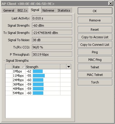

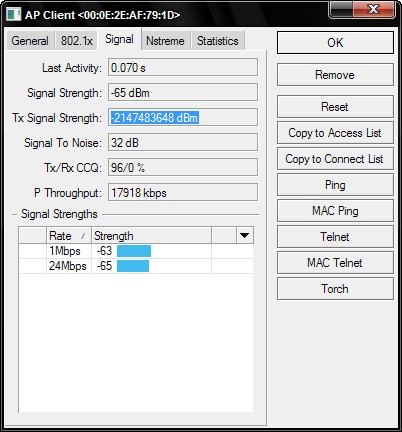

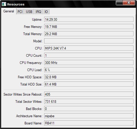

after the upgrade to 3.22…RB411 as AP with different clients like Edimax, Trendnet.

it was working properly until 3.22
I’ve noticed the same thing on our 411 AP, all clients running MikroTik (133’s & 411’s).
Signal strengt we’re flying from -50 to -1234556767.

I have noticed that this problem only occur when non Mikrotik or ROS systems connect to a to an AP running ROS 3.22.
You do see the problem when two systems running Mikrotik ROS connect.
I’ve seen on a mikrotik bridge for one second and then the signal is normal again, not only on non mikrotik.
I can confirm that this bug exist also with a AP mikrotik 3.22 [433AH] with a CM9-GP and a windows client connect to it:

3.23 did fix it…but it fix the problem by having a ‘blank’ field of TX :frowning:
It should be blank. It will only show the TX info if on the other end will be RouterOS, as the other end sends this info.
Or Nanostation
