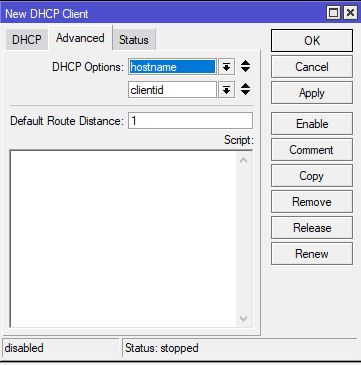

Next question is how do I achieve it ? Those automatic routes don’t seem to be “editable”, at least not from Winbox…
Anyone … ?

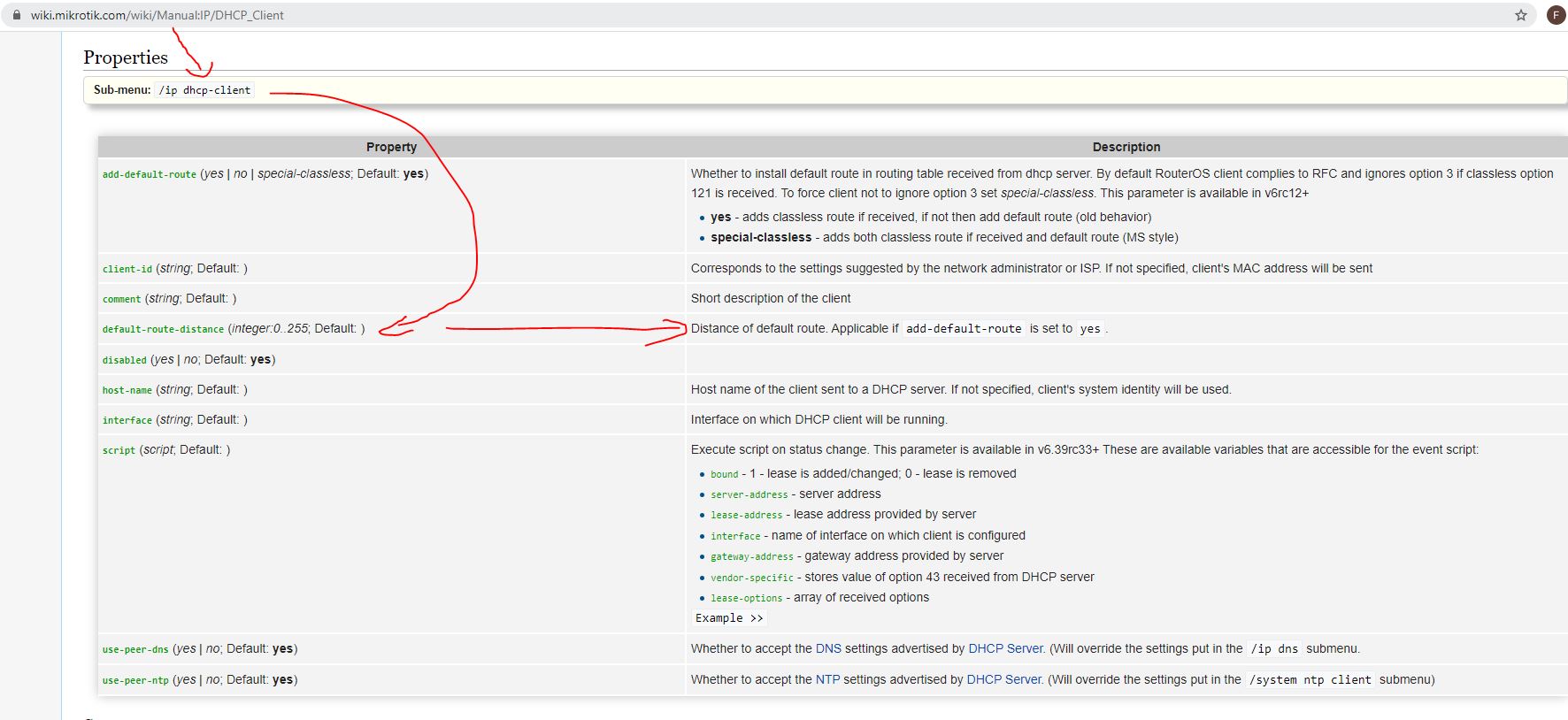

Some things you should try to do yourself atleast, below is where you can change the default route distance on a DHCP client
More than happy to do so and to learn but quite frankly had no idea how to change the default route distance on a DHCP client… Thanks for your help there !
Pleasure, glad you got sorted, see below for future:
