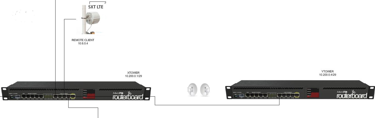

A strange routing issue, works if OSPF is disabled
Here is a diagram of the network, basically its just two routers with a wireless PtP link between them.
So, the address of this side of the link is: 10.200.0.4/29 and the remote side is: add address=10.200.0.1/29
The issue is that if I disable the following I can access the remote pppoe clients.But if I enable it, I can not even ping the remote clients.

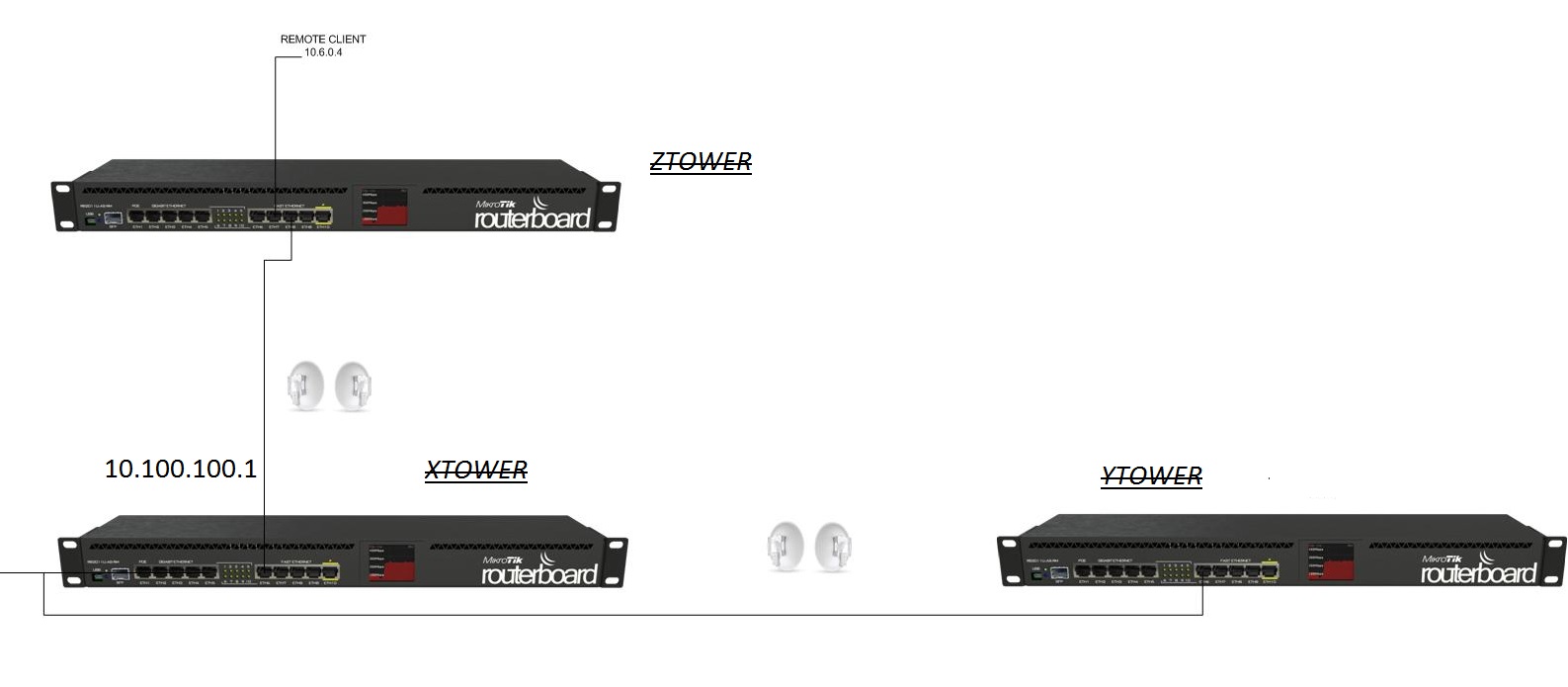

Firstly, my map was incorrect, please find correct map below. I apologias for this.
Anyway I have done as advised,
Torch the interface at 10.6.0.4 to see if your requests from 10.200.0.4 are arriving and departing.
Result: Without OSPF:
Src: 10.6.0.4 Dst: 10.100.100.10 (XTower interface)
Works
Result: With OSPF:
Src: 10.6.0.4 Dst: 10.200.0.4
Does not work
So, when OSPF is enabled, the Router(ZTower) tries to reply directly to 10.200.0.4, instead of going via RouterX. Or whats happening and how will I solve it?
Your new figure contains nearly no IP address labels, so I can’t follow your explanation.
If you have determined that return routing of messages from 10.6.0.4 is failing with OSPF enabled, then run a traceroute from 10.6.0.4 to the original origin of the message, examine the results with OSPF disabled and enabled, and determine where in the path OSPF is breaking the routing, then why.
Here is the map with IPs
Right now, I changed the 10.200.0.0/29 network in OSPF to another area, External area which I had created previously (Client CPEs are on the external area)
So this is a temporary workaround, as it gives me the routes required so that I can access the CPEs on YRouter but it does not receive specific routes for all other CPEs on the network, yet it can reach them as it only has one gateway, and that is to XRouter (core)
But I would like to peruse this issue to get to the bottom of it and increase my knowledge
I have already told you the most straightforward way to pursue this issue. Let me know when you have performed it.
Thank you very much, you helped me by pointing out the torch function.
The issue was a firewall rule that was dropping invalid connections (default mikrotik firewall)
Once that was disabled it worked fine.
