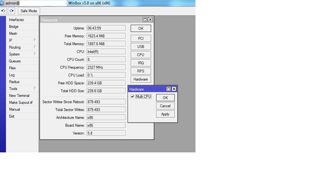

I have install ROS 5.8 and working but when i ping to loopback adapter address 127.0.0.1 latency is lies between 5 to 10 ms .
