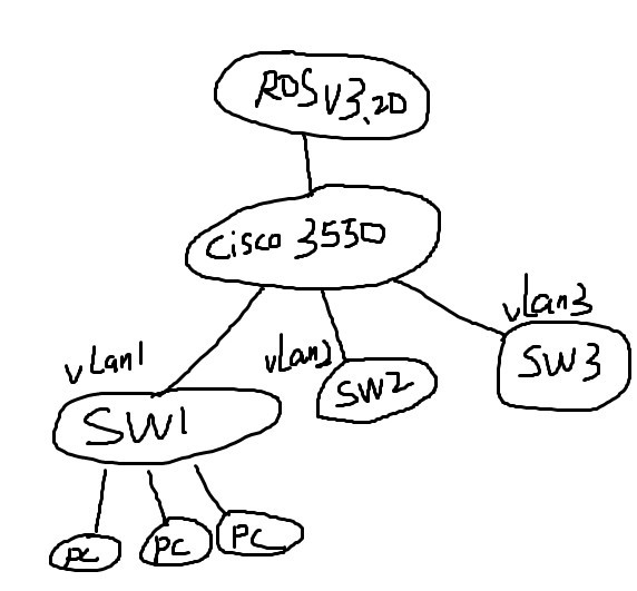

this pic is my lan network topology.
i seeting the dhcp-reply function on the cisco 3550, the real dhcp-server is ros .
and the arp is enabled on the interface. but i can not bind the ip by the pc mac address.

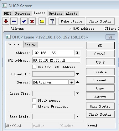

when i added it’s ip and mac address on dhcp-server lease, it can join in the net. plz look here.

ADD: For example, the mac-ip set in the screenshot above, click the “Make Static” button. That mac address will always get that ip when it requests one (renew ip lease).

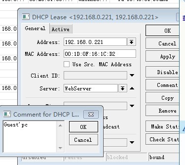

That is what the comment parameter is for. For each dhcp server lease, make the lease static, then add the name of the user in the comment. Users without anything in the comment are “unknown” users.
