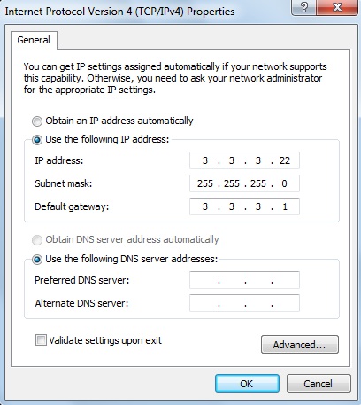

See the attach image. these are IP i give to access AP.

Give this address to the port or bridge where the ap is connected to. Check the routes and ap accessibility from the router. Then it should be also accessible from the computer.
Why 3.3.3.22 ? is this realy your internet ip, or something you chose ?
