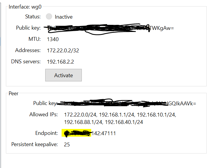

a wireguard server is my MT router installed in my office.
a wireguard client is my windows machine in my home.
so my situation like this ..
i already have a wireguard tunnel that worked well with my current configuration, however my problem is that when i establish a connection using my wireguard interface from my windows machine
i did not get the puplic IP address of my router, other wise i stay with the public IP of my home network, so anyone know how to make all the traffic go through this tunnel..?

(1) Error Allowed IPs. you should be stating the subnets, 192.168.1.**0/24,192.168.10.0/24,192.168.88.0/24,192.168.40.0/**24
The allowed IPs on the windows side could be the single entry of 0.0.0.0/0 if you wanted internet access as well.
(2) Why do you have 192.168.88.??? and 192.168.40.?? They do NOT exist on the router???
Looks like it should only include 1.0 and 10.0
(3) As for DNS, try using 172.22.0.1
and if that doesnt work one of the DNSs that are used on the office router maybe 1.1.1.1 etc…
(4) Why using MTU of 1340?
first try both set at default 1420 and then both at 1500 for example. ( both ends of tunnel same setting )

Hello Mr anav..! as always thanks for your replay..!!
WINDOWS:
1-Error allowed IPs: so its not that’s error, yes we can set it as you mention. however, it work well IN MY current config, i try to relpaced with your recommendation but i didnt find any different..
2-yes only 1.0 and 10.0 is the available address, i was testing some other ranges that’s why
i have those guys there.
3- yes i try to playing around DNS alot including what you mentioed above but all this attemp with no avail.
4-actually when i set my wireguard tunnel from the first time i encounter a low tx and rx transition between my wireguard server -router- and my windows machine, so i begain to change the
MTU in client side until i reach to 1340 as the best value for this connection stable and efficient

Hello Mr anav..!
it work ..! i just change the allow ip address to 0.0.0.0/0 and all thing goes fine..!
