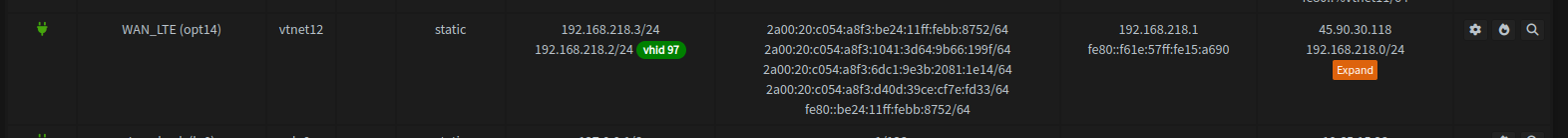

2.) The OPNsense behind the Mikrotik also received an IPv6 address from the Mikrotik:
3.) But i’m unable to reach the OPNSense WAN_LTE IPv6 Address from the Internet.
