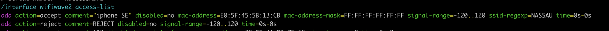

and it still allows everything.
Remove the time= setting … as far as I understand the logic, the rules will only be matched for a fraction of second at midnight (0:00:00). If you would like to add check for time of day (and have rule matched at all times), then you’d have to write something like “time=0s-1d”, but why bother with this property if the rule should be time-independent?
If webfig doesn’t allow removing it, then do it via CLI. However … my WebFig did include the Time line (with all zeroes), but if I removed the setting (pressing the upwards pointing triangle and then save the ACL rule, the time property was not seen as set in CLI.
thanks, not working. Even if I remove it, it puts back when clicking APPLY on the rule. I’m trying this from the webfig. I was also trying with 00:00:02 00:00:01 that’s 24 hour -1 second but didn’t allow either. no effect…
UPDATE: Something is definitely with the time… I’m messing around and it started working. let me do some thorough testing… THANK YOU! for the hint
I actually went forward to test my suggestion before posting it. And my suggestion worked.
It seems to me that WebFig has a bug which causes it to add the time properry if it didn't exist before opening the particular rule. But if you remove it and hit "save", it's not added to actual router config. Just verify it while using another UI (I used CLI, winbox might be a good example to get "second opinion" if you fancy GUI).
And you're not right about 00:00:02-00:00:01 ... the end time has to be larger than start time ... and 00:00:01 is one second past midnight which is already past when interval starts (at two seconds past midnight). However 00:00:00-1d should be fine as "one day past midnight" did not happen yet when interval started at "today midnight".
