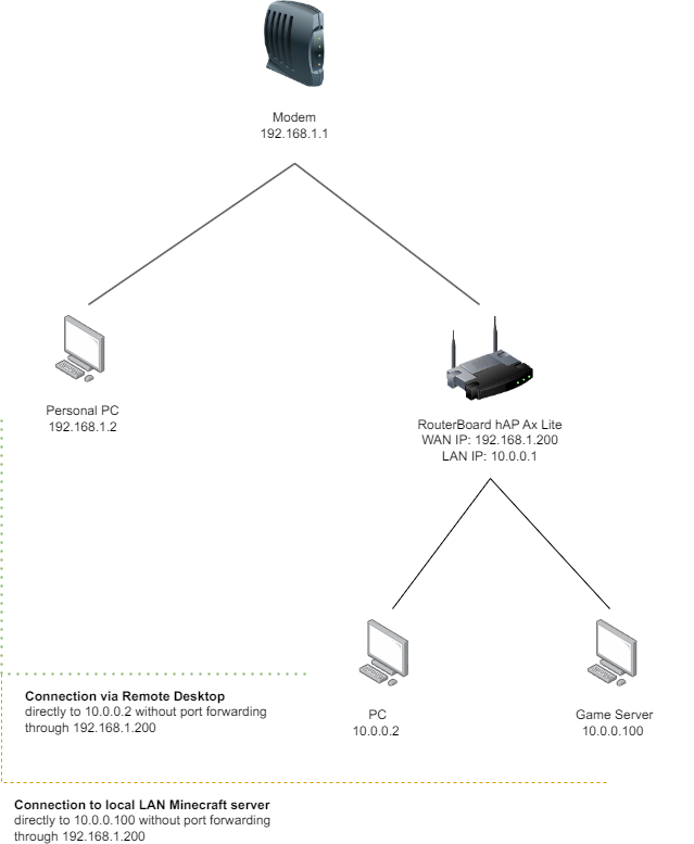

This is what I really want to do if it helps or makes sense
I think this will definitely break other things I’ve configured prior, the static route and firewall filter rule makes a lot more sense but I’ve no idea why it doesn’t work

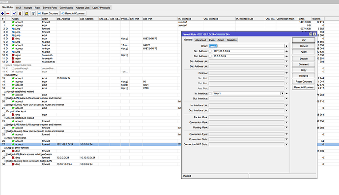

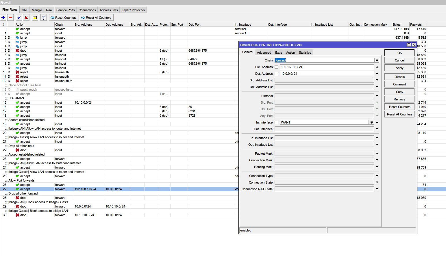

Can you try to put, as @TheCat12 mentioned,
add action=accept chain=forward src-address=192.168.1.0/24 dst-address=10.0.0.0/24 in-interface=WAN1
before the rule
add action=drop chain=forward comment="Drop all other forward"

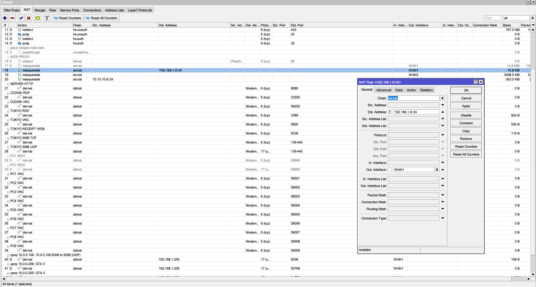

And then change the rule
add action=masquerade chain=srcnat out-interface=WAN1
into

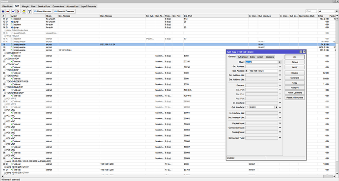

add action=masquerade chain=srcnat out-interface=WAN1 dst-address=!192.168.0.0/24
Did that but still no luck
I tried changing the NAT rule to exclude 192.168.1.0/24 instead of 192.168.0.0 as you typed too

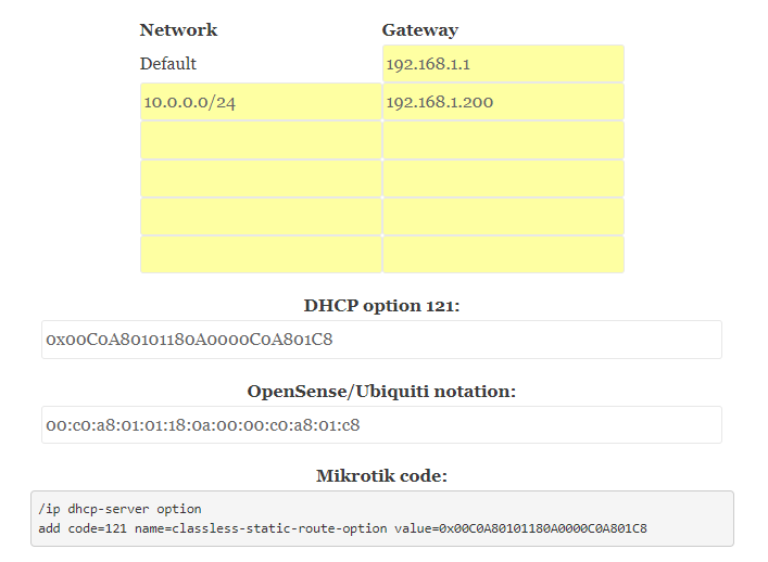

If there are too many devices, or mobile devices with no easy way to add routes, you might try this “crazy” idea: Make the MikroTik device the DHCP server of the 192.168.1.0/24 side. The Huawei device still has the 192.168.1.1 address and still is the gateway. And the MikroTik device still has the 192.168.1.200 address. You turn off DHCP server on the Huawei device. Turn off DHCP client on the WAN interface of the MikroTik device. Still on the MikroTik device, configure static address 192.168.1.200/24 for the WAN interface. Add static default route 0.0.0.0/0 gateway 192.168.1.1. Configure DHCP server on the WAN interface, with network 192.168.1.0/24, Gateway 192.168.1.1, DNS server of your choice. On the MikroTik firewall, chain input, allow incoming request to UDP port 67 (because normally the WAN interface of the MikroTik router blocks incoming traffic).
At this moment, the MikroTik router acts as the DHCP server for the 192.168.1.0/24 LAN of the Huawei device. It still provides the default route information with 192.168.1.1 specified as gateway to the DHCP client. But now you have the ability, with DHCP options, to add additional routes for the DHCP clients. Namely an extra route with destination 10.0.0.0/24 gateway 192.168.1.200, using DHCP option 121 (classless static route). Look at the examples here:
https://help.mikrotik.com/docs/display/ROS/DHCP#DHCP-Example
https://www.jm.technology/post/mikrotik_dhcp_static_final/
You’ll need to specify both the default root for 0.0.0.0/0 gateway 192.168.1.1 and 10.0.0.0/24 gateway 192.168.1.200 using the Hex values as described by the links above. Or you can use this page to build the Hex strings for you:
https://www.medo64.com/2018/01/configuring-classless-static-route-option/

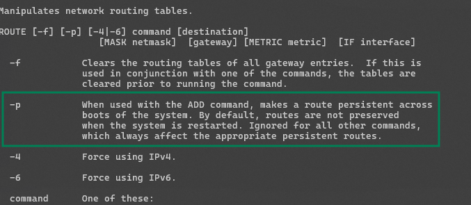

Great! but if you use Windows, don’t forget the -p switch to make the extra route persistent across reboot!
