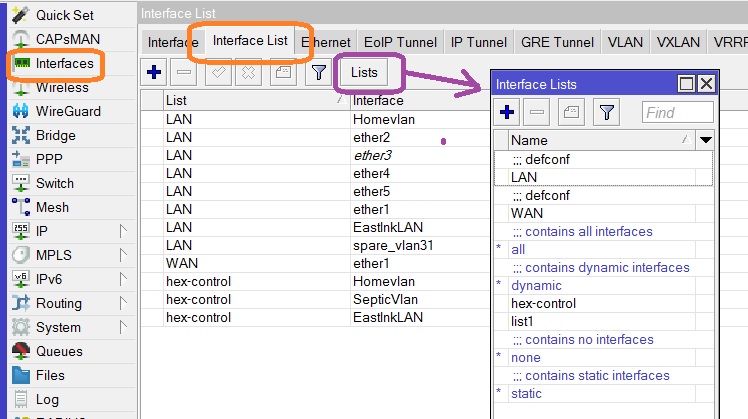

OK, I see. Thanks guys for the information. I did look for a LAN list but I didn’t really find a list in the GUI that actually listed out the LAN interfaces. I’ll have another look when I get a chance.
Interfaces->Interface List

I saw that. When you click LAN, it just says list = LAN. If you click “lists” and then click “LAN”, it’s empty.
Button “Lists” shows another window where you define lists. And main window shows lists and their member interfaces.
