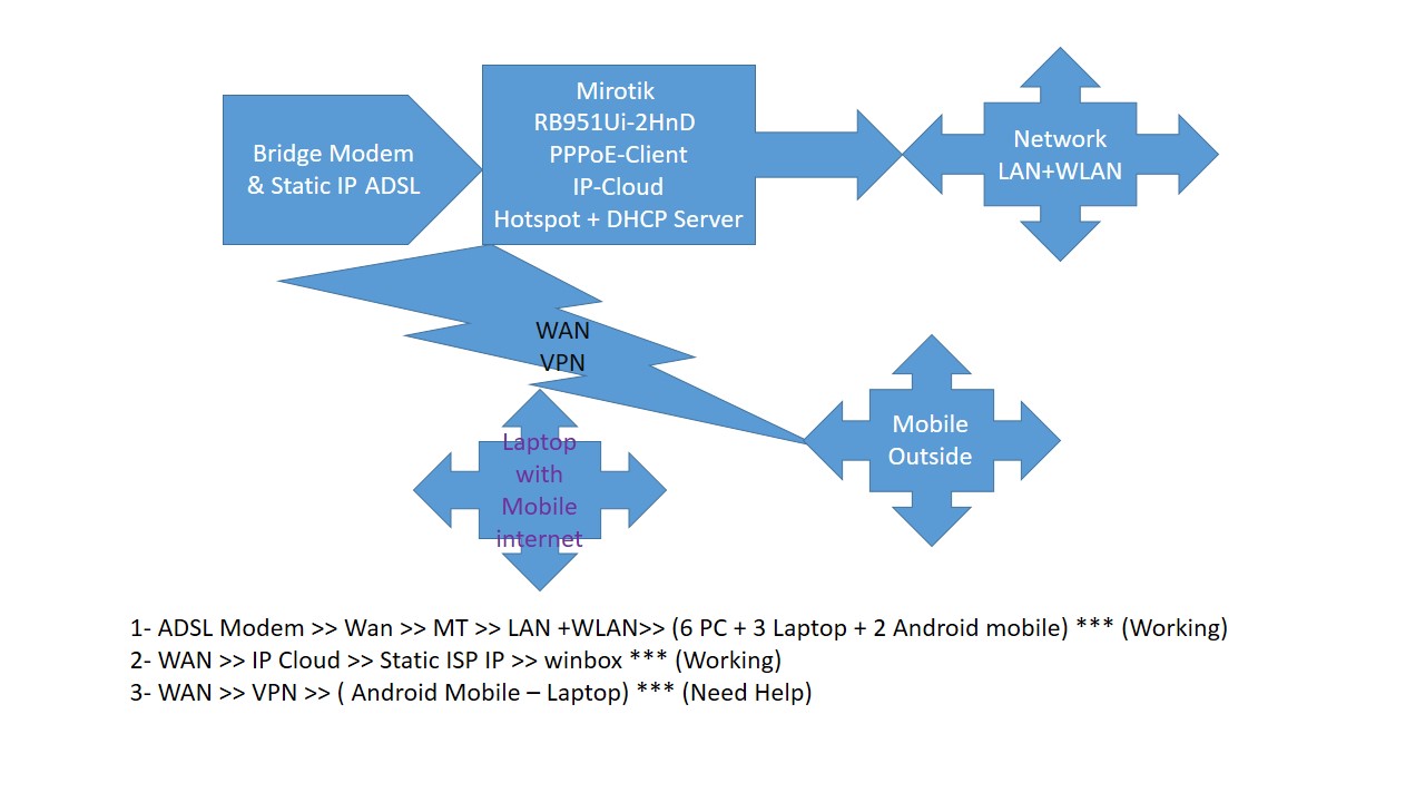

my network like that
modem bridge >>WAN >> MT (PPPoE_client with static ip ) hotspot - ip cloud - dhcp server - >> LAN + WLAN
i want login via wan vpn connection outside my network
do you know why sir?
i think i can get internet bandwidth from MT to my mobile or laptop
i see that in a friend network but not with mikrotik
with sophos server
i think its very near software and hardware from mikrotik
i hope you get me
sorry for my bad English language
best regards
