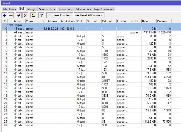

I suspect the “network engineer”!! Who set this up has made a right pigs ear of it.. If I go to the externally published address without any port - it goes straight to my Router login page, which I doubt is a good idea!!!
Ive attached what it currently looks like (I just put in the top line from the video you posted.)
