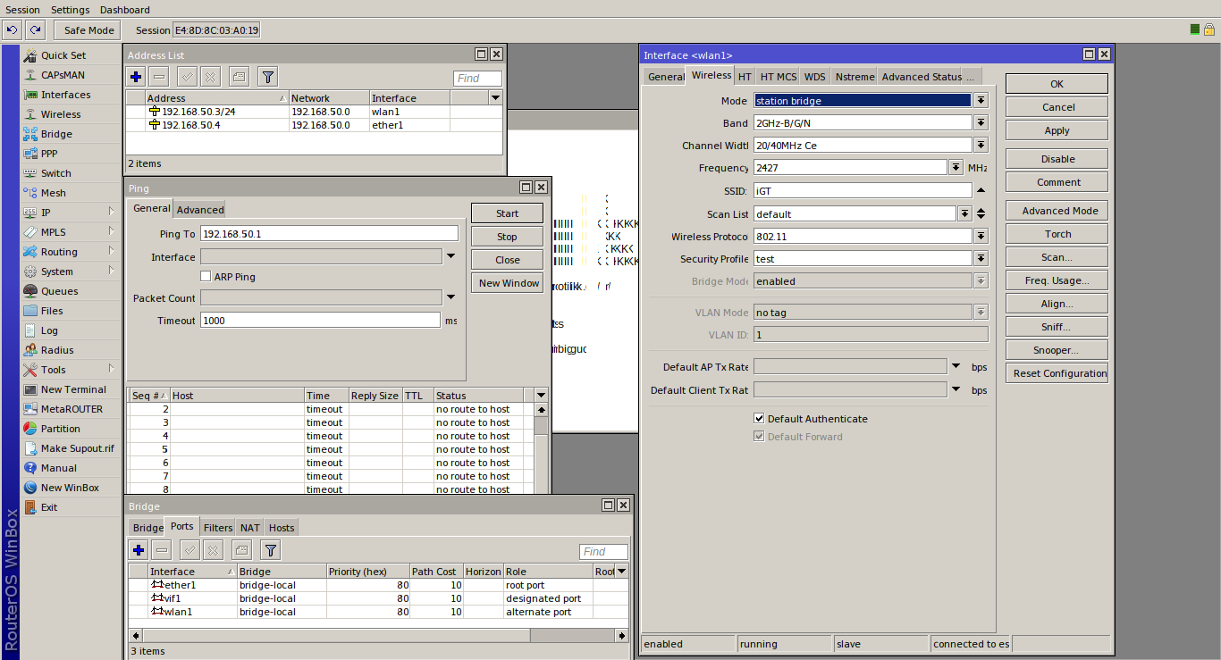

I want to connect my mikrotik RB912 (as slave. 192.168.50.3) to second mikrotik RB912 (as master. 192.168.50.1).
On slave mikrotik I have OpenWRT on metaRouter and as long as I am using Ethernet connection I have access to it.
I did this tutorial http://wiki.mikrotik.com/wiki/Connect_to_an_Available_Wireless_Network on mikrotik slave, disconnected Ethernet and I can’t ping mikrotik slave from my laptop.
My purpose is to can access mikrotik slave in my LAN area. But I want to be connected via master (it has access to the Internet). So slave has to be connected to master (AP) and I want to be allowed ping slave mikrotik.
I don’t know what should write here to help understand my problem so you can as about details.
On the screen is ‘station bridge’ but I have set ‘station’.
I add that in wind box I see that there is 192.168.50.3 (when Ethernet is disconnected) but I can’t connect to. Bu if I choose MAC connection I can access slave RB912. So the connection exist but I can’t ping it.
