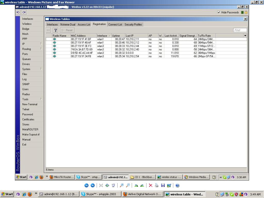

what does wireless tab on left side of screen show for signal strength on tx and rx also what does noise floor show?
Yes, show us the full configs and also tell us how you do the speed test?
There can be many things wrong but a 433 is definately able to supply much higher speeds.
Side note: rb433 is only the routerboard. It is depending the wireless card and how it is configured on what the wireless performances will do.
routerboard is only the manager of the card. But a bad radio link is nothing even the fastest motherboard can fix.

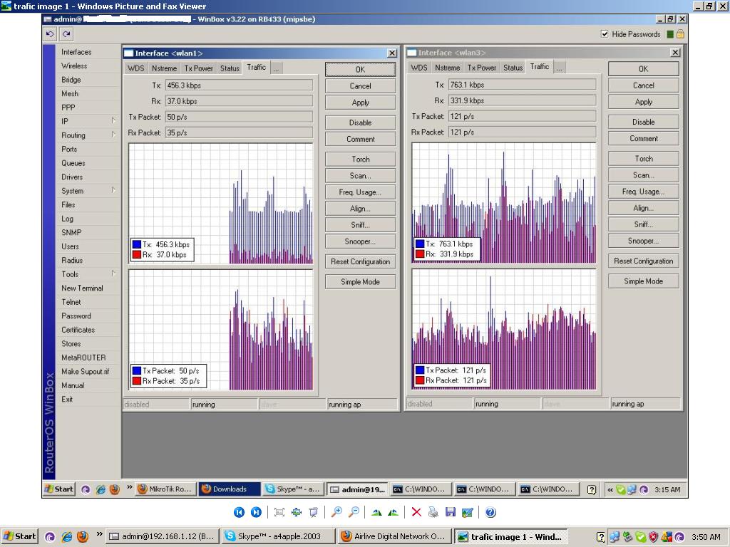

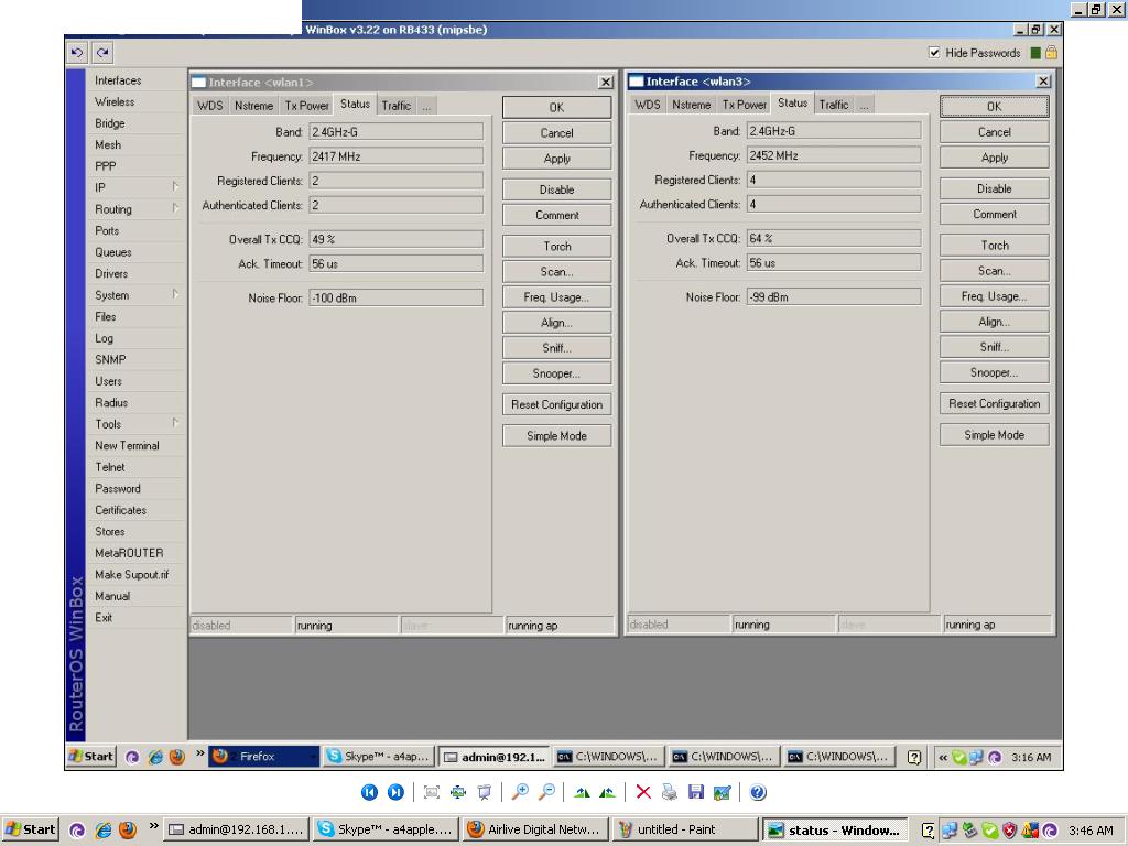

Still not so much info. All I can distil of the pictures is that both AP running cards have some clients attached and some traffic is running over the AP’s interfaces.
Furthermore both wlan interfaces show low CCQ’s which means the average package loss over the wireless is high.
This can have several reasons. Bad links with insufficient Signal to Noise ratio, interference, misconfiguration or clients etc. or just very low usage on clients.
You need to give interface / wireless export print for the AP and preferably also for a client on both of the AP’s.
Also, if you run a scan on either one of the AP’s sectors in 20 and 10Mhz band, and the same for clients, I would like to see the results.
Maybe start with on AP sector only to improve and copy that into the other.
Also, how far are both sectors located from each other and in what direction?
Links to the clients, do they have free LOS? And sufficiant Fresnell? (If you don’t know what this all is, google a bit. Best way to learn.)
If measuring the throughput over the wireless link you also need to run traffic over it. Best is to attach a PC to the client and download a big file from the internet and than look at the wireless interface of AP. This way the routerboards of both AP and client don’t have to produce or receive the datastream, only pass it.

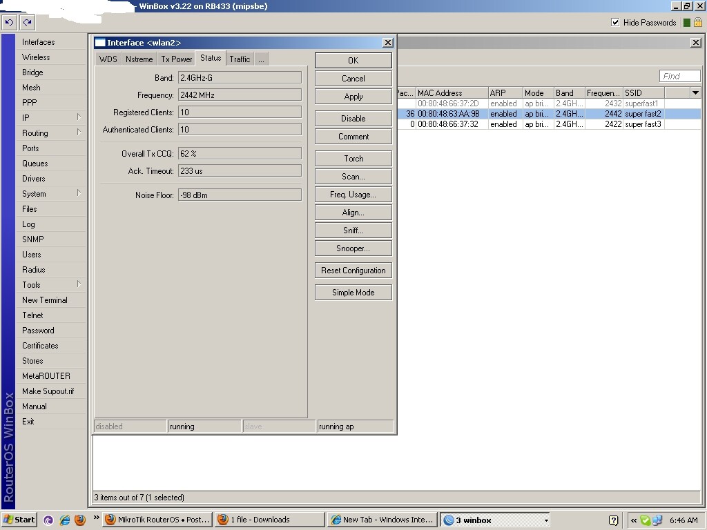

Ok, change ANI (Adaptive Noise Immunity) to Client and AP mode on each interface running as client.
Secondly, I see you have a mix of 802.11b and 802.11g clients connected. Meaning the whole network degrades to a ´b´ network anyway.
I need to link quality of each single client. SNR (Signal to Noise Ratio) should be 20 or bigger.
CCQ of each link to a client should be above 70-80 under load conditions. I only see the general beeing lower. But that can also be because some clients are running a bit idle.
How do you test your throughput anyway?
Your internet connection. Where does is consist of?
These stations, are they laptops? What distances to the AP’s?
You need to start reading on this forum and search for wireless issues.
There can be so many things wrong on wireless links that actually it is magic if it all works flawless!

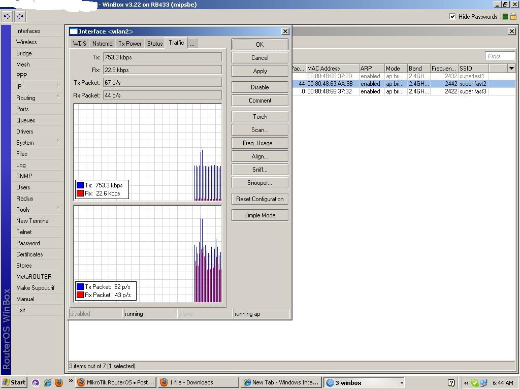

the distance between access point and customer end is approx 2 km and total number of pc are 30.
to check the throughput by downloading the file generally it is good.but the rx is not encreasing at all to 100. the rx of wireless interface within 100 (average).
there are only five customer on the access point (one of the wlan3) (and three cusomer on wlan1 )
and i disabled the middle wlan2 interface for self interfracne and performance reason.
all all client gaining good speed but one of the newly added customer (with nine pc)facing the problem . when all client are connected to the ap then time ms is going in three digit. i have changed the frequency but no luck:
