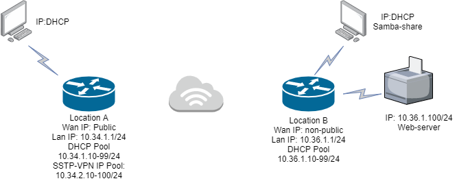

How access remote LAN?? I have tried to make this work for a long time and google is not enough I need help, or at least help to push me in the right direction..
I used this guide to setup the a sstp-server and it works great, I got router in location B to call location A and a connection is established but how to route trafik to location B so I can talk to the printer (no need to print, only access it´s web server) and a client (samba) and the MT-box via winbox from location A
I am not sure of they guide you used, but if you see the example in the wiki fot a site-to-stie SSTP, you will see that it mentions clearly …Now we need to add static route on Home router to reach local network behind Office router…
So on both your Sites you should add a static route pointing to the other side of the tunnel. In case of the server instead of adding a static route you can type the Route under the Routes box of the Secret facility and when the client connects the route will be dynamically created, unlike with the client that must be static…
See here : https://wiki.mikrotik.com/wiki/Manual:Interface/SSTP#Site-to-Site_SSTP
