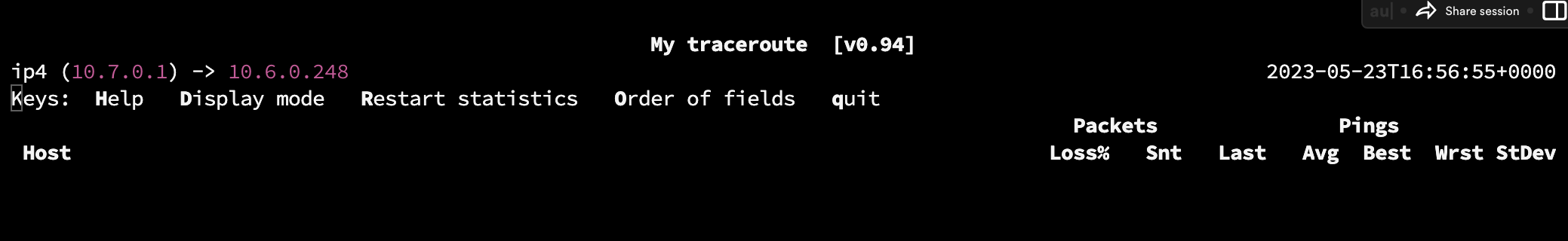

but after this I can’t still ping 10.6.0.0/24 network [screen from VPS] and from device connected to VPN (phone)
