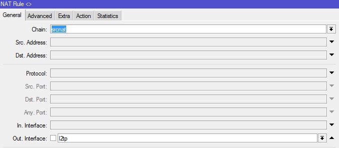

Actually I have 3 interfaces Eth0, Wlan0 and l2tp interface, to get that vpn client works I only add a Mangle rule and NAT rule

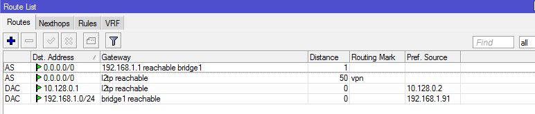

Antd this is my router table

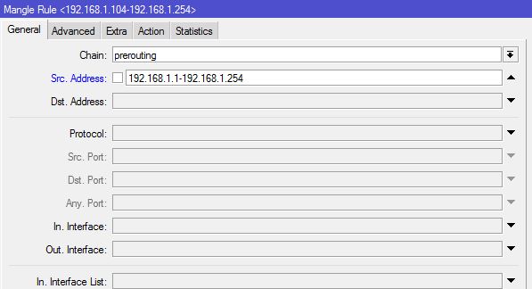

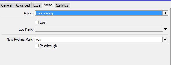

Actually I only can to decide if I want that all trafic go via vpn or via eth changing in mangle rule the ip range to choose the computer that output via VPN

Thanks very much I have created an ip list with the ip of the site that I want to go via vpn and then I add the list in the mangle rule as destination list and it´s works fine.
