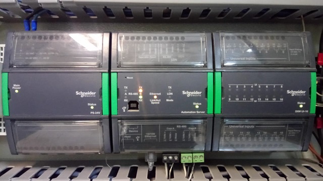

Access UDP port 47808 via PPTP VPN
I’m using mikrotik RB750 for my office.
I’ve configure the PPTP VPN and it works fine. I can access the server (192.168.1.5) and other devices through it.
Every time I want to access device01 (192.168.1.42), I just need to connect to PPTP VPN and remote to the server (192.168.1.5). Then I use an application from the server to access device01.using UDP port 47808.
Now I want to access device01 without remote to the server first. I have copied the application that used for accessing device01 from the server to my laptop. I also make sure that device01 can be ping when VPN connection is established. I use the same PPTP VPN.
I run the application from VPN, it can’t connect to device01 using UDP port 47808. But when I connect directly to LAN, the application is able to access device01 using UDP port 47808.
Here is the mikrotik configuration.

And this the device that I want to connect into
Pls advise.
Thank you.
