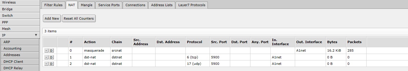

Now, I tried to forward Port 5900 to the PC, which has a static DHCP-lease of 192.168.88.10
Using the manuals from the wiki, I try but fail. I think I configured everything right, yet I can’t seem to connect via VNC from outside.
I attached some screenshots from my IP/Firewall-Configuration.
In the Picture “2.jpg”, the “To-Address” and “To-Port” are configured to 192.168.88.10 port 5900:
I hope you can help. Thank you.

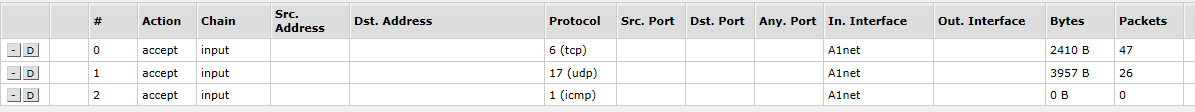

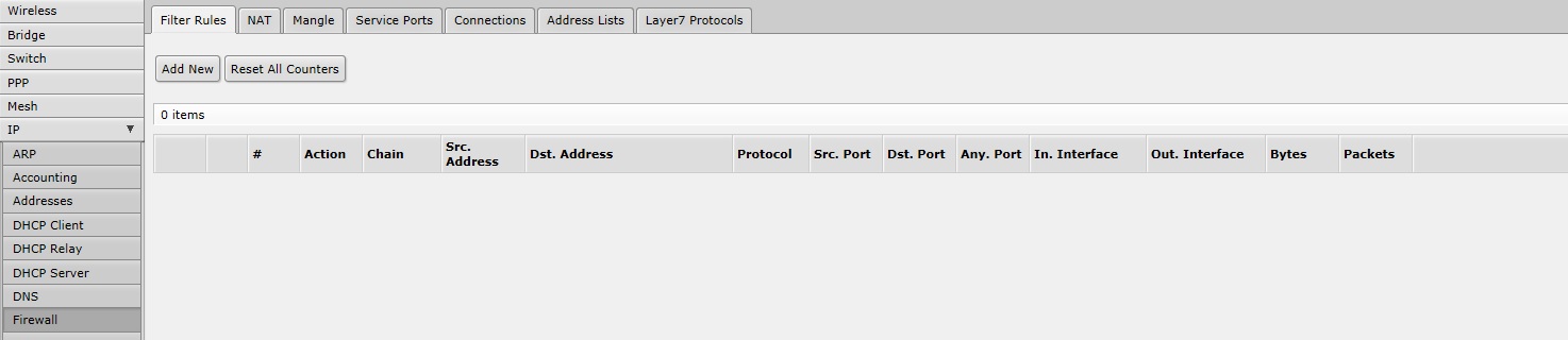

Update:
This definitely seems to be some problem with outside access to the router.
When I use the routers 3G-Connection for internet access and try to ping the 3G-Interfaces public IP (or the Dynamic-DNS hostname) i get the full response.
I also can access the webfig-Configuration-Page using the Dynamic-DNS hostname.
However, when I use a altogether different internet connection, I get no ping-responses and can’t access the webfig…
Does anyone know the reason for that?
I also tried adding some specific filter rules to allow tcp/udp and icmp-traffic (see attachment)
I’m really at a loss for what to do…
