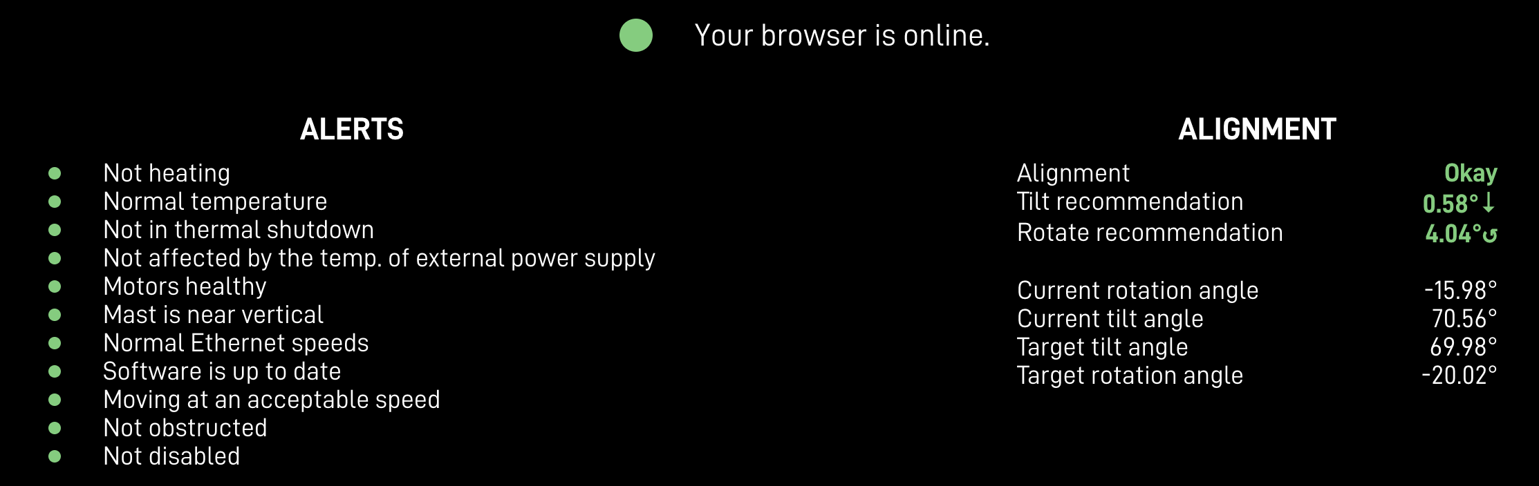

With the GL.iNET router, I was able to access the Starlink stats, alignment view, etc., by connecting to 192.168.100.1 via browser. Now that I’ve switched to the hAP ax lite, I can’t seem to do that anymore. I’m guessing it’s something in the firewall or NAT that’s blocking it?
I can still use the Starlink mobile app, since it connects to the dish via the internet, but I’d prefer using the browser, since it gives a more detailed alignment view.

That did it! I used winbox (nice that it’s available for Mac as well!), since I’m more of a GUI person. :sweat_smile:
