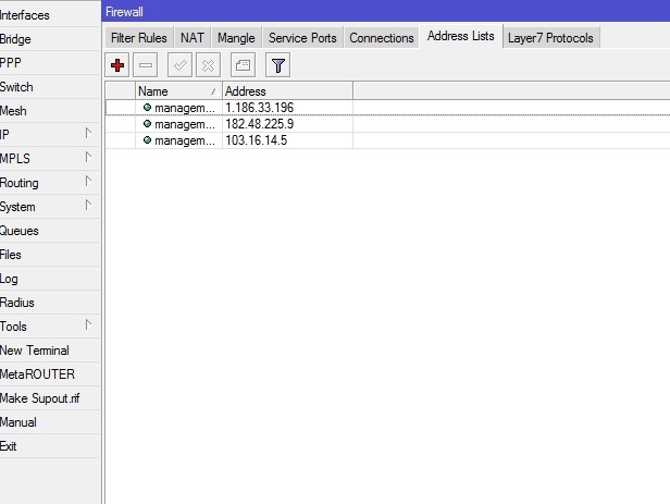

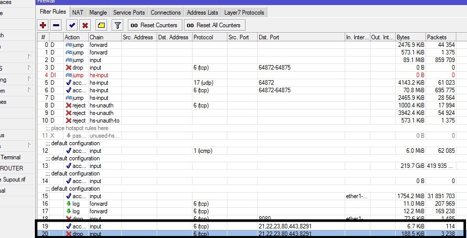

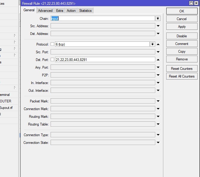

I dont thing so the firewall command will help for the secure access, kindly suggest us which one is good to control the mikrotik access control? My consecrate is it’s should be able to access form all places, it should be able to access only from defined IP’s?
for the above command , I have created the Management servers in the address-list, then I have written the rule in firewall & same time i made the accept for only Management server IP’s & made drop for all but it didn’t help to block the access. here with i attached config sheets . kindly help me, if this won’t work what is the purpose to use this firewall comment.
