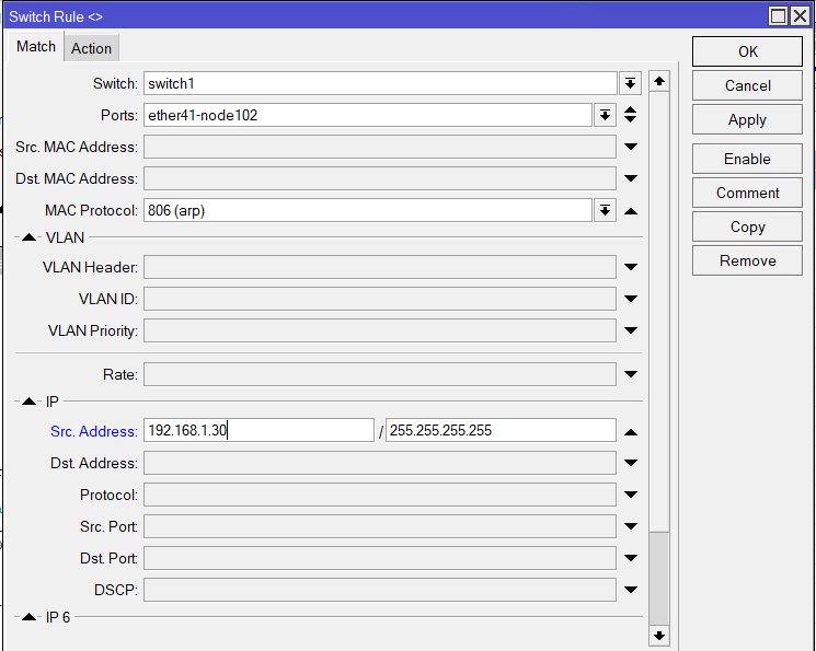

So it doesn’t make sense that creating the rule where I specify ARP and also specify the IP makes it work.
This is the rule that I have to add additionally, which I didn’t have to add before for it to work:
before it worked only with this configuration:
it is understood that if I do not select any mac protocol it should be all of them
Yes, it does. But still for ex. an ARP packet does not have a src-address, as it is not using IP. So it does not match the 1st pass rule, but does match the 2nd “block all” rule and hence gets dropped.

If I consider creating a general rule to allow all other traffic (ARP, IGMP, etc.), but a client sets an IP address that doesn’t belong to them and is already in use by another client, this will cause connectivity issues, since ARP will be permitted and the router will see two different MAC addresses.
Regarding the statement that an ARP packet doesn’t have a source address, it does actually make sense, but then why is the issue solved by explicitly creating this rule?
add switch=switch1 ports=ether41-node102 mac-protocol=arp src-address=192.168.1.30/32 comment=“Allow ARP explicitly”
That’s a good question and hard to answer without knowing how ROS handles rule properties not making sense for the mac-protocol. Like IP src for ARP.
My guess is the rule with only the IP src does not match any non-IP packet. While the rule with mac-protocol=arp ignores the IP src part and matches any arp packet. This is just a guess and can be tested by changing the IP src part of your ARP rule and see if it still matches.
Technically ROS should reject (or warn about) a rule specifying IP addresses together with a non-IP mac-protocol. It is also possible that such undocumented behavior changed btw. older and current ROS versions.
