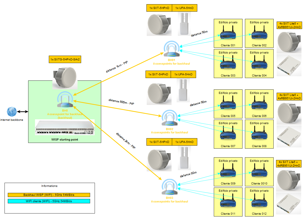

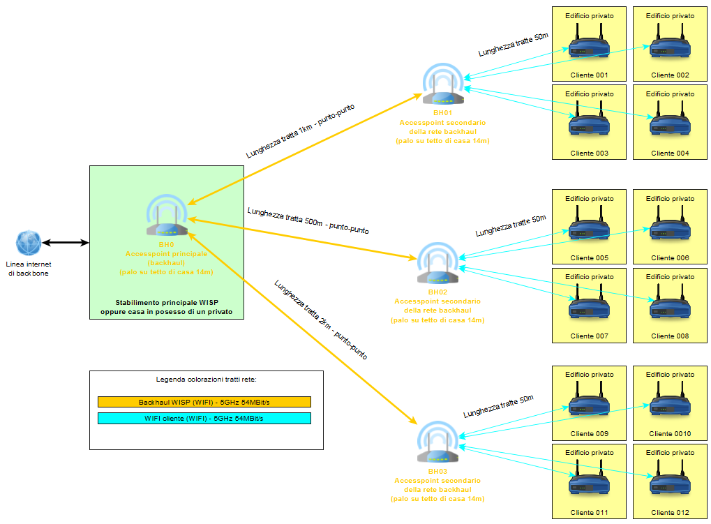

I suggest:
One RB1100AHx2 as router, gateway, pppoe-server, DNS server, NTP server, RADIUS by user-manager.
For PtMP I can suggest some devices, but depend on the angle of each building from the center of PtMP
If are inside 90°, one SXTG-5HPnD-SAr2 for PtMP master and 3 SXT-5HPnD as slave.
If are more than 90° add one SXTG-5HPnD-SAr2 as separate devices or made PtP using two SXT-5HPnD
At this point one OmniTIK UPA-5HnD as AP for the CPE. The OmniTik also power the SXT-5HnD and is not needed any other router or switch.
For CPE for the client, one STX Lite5 powered by one RB951Ui-2HnD acting also as Home AP.
All the device you need (excluding failover) are:
1x RB1100AHx2 [$349]
1x SXT Sixpack containing one SXTG-5HPnD-SAr2 and 5 SXT-5HPnD (2 are for spare or used instead of SXT Lite5) [$445]
3x OmniTIK UPA-5HnD [$99 x 3]
12x SXT Lite5 (or 10 if the 2 SXT-5HPnD on SXT sixpack are used instead of SXT Lite5) [$59 x 12 (or x 10)]
12x RB951Ui-2HnD [$59,95 x 12]
TOT. $2518 (or $2400) = 1881€ (or 1497€)
Yeah man! This is more than I would have ever dreamed about!
To make this public i have changed my scheme to show it to everybody out there!
For the RADIUS we would use our external radius server..but for the rest..
I am really impressed about this help!!
Ah, one thing… if one of the three points can be viewed from all clients, you do not need all three backaul, but only one…
