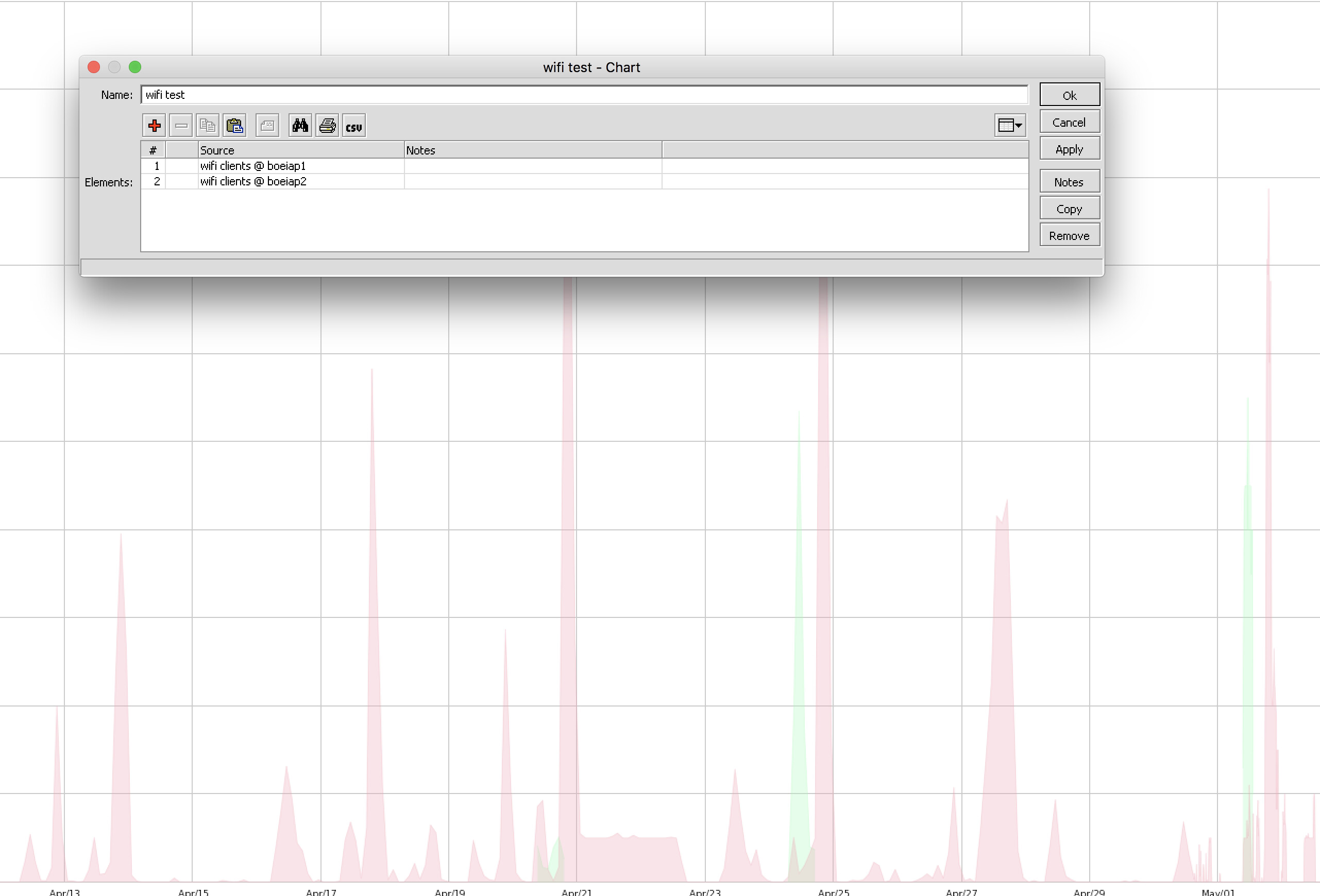

If the graphs have the same y-axis metrics then they overlap automatically in the graph page of the device. I use that for voltage and temperature graphs…
The 2 lines in one graph is not a problem, but I want to stack the values to see a maximum in the graph …
i have used the dude chart function to add many sources on one graphic to get the graphic you mention
The screenshot below shows a graph with 2 lines from separate devices. I want to stack them, not to show them side by side … I can not find a wy to do that …
So 1 line with the total of both devices added together.

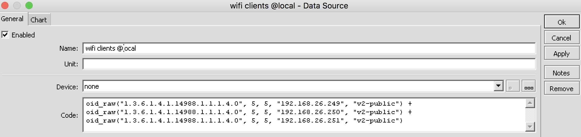

The 2 OID are from different devices …
I know that would be the direction to look into, but I can not find how to add snmp oid from 2 (or more) devices into 1 datasource …
Found it …
not that hard after all, tnx for the suggestions.
create a datasource for device “none” and put some function code inside
create a graph for this new datasource
