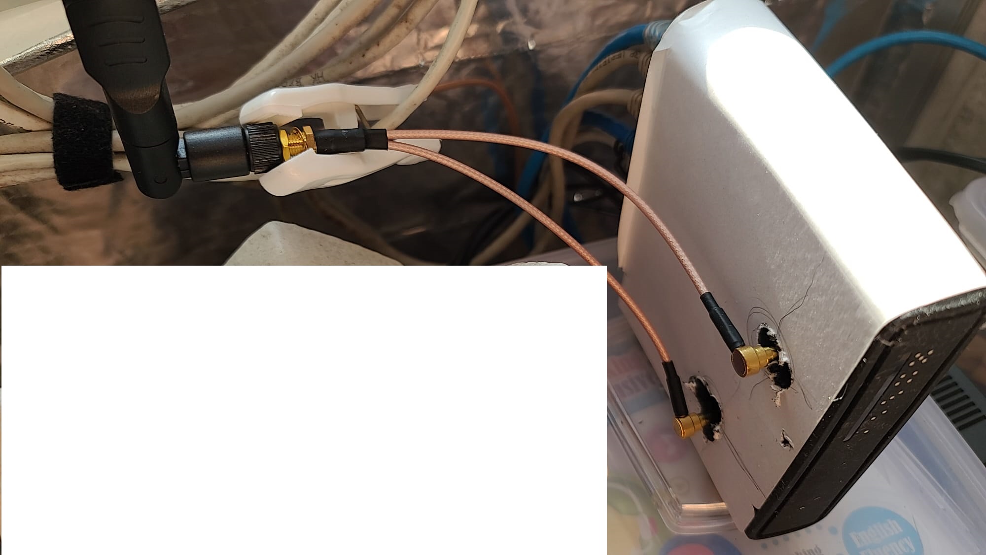

same here, I want to add a ASUS RT-AC56U as a repeater because the Mikrotik hAP ac2 wifi signal is too weak. I have already add an external antenna which didn’t improve the wifi signal.

What kind of antenna did you use? Does it actually integrate two independent antennae? If it does not and you simply soldered two coaxial cables together, they you may damage your hAp ac2 by using antenna connected this way …
