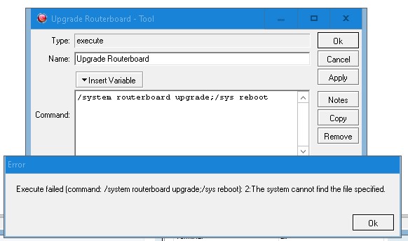

I’m new to using Dude. I’m trying to add a tool to upgrade the Routerboard after an OS upgrade by adding a Tool. This command runs successfully as a script on a router, but if I try to use it as a Tool in Dude, it fails. What’s the correct way to easily run a command like this? Thanks in advance for your assistance.
Manual:The Dude v6/Tools - command will be executed on the Dude client OS, bot on the Dude server.

Thanks for the response. This is indeed true. While digging deeper yesterday I discovered this and verified it by creating a Winbox tool. Obvious now that I see it, but at first pass it wasn’t very clear.
