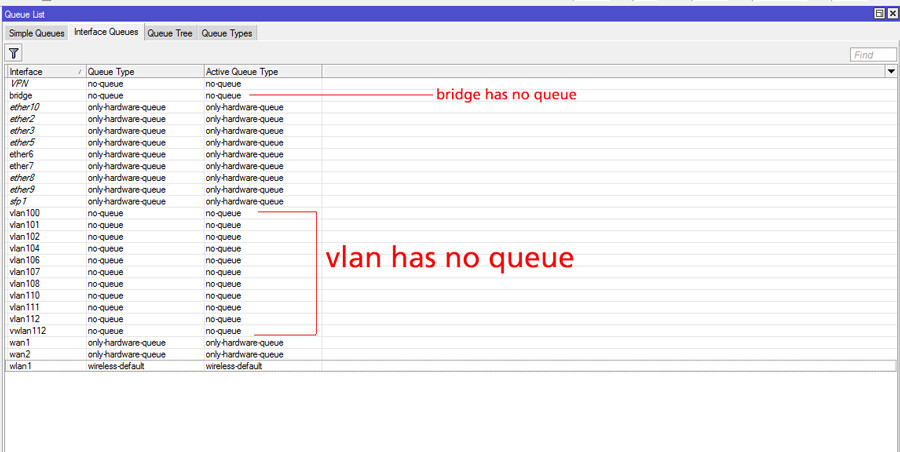

reallly thanks , there is one point if you don’t mind , i noticed that in Interface Queue , all Vlans has no queue type( no-queue) like other interface which is (only-hardware-queue), Should i make type of vlans as (only-hardware-queue), and what about bridge interface , also has no queue ?

like this
This is correct for hardware queueing - the vlan interface is just a virtual thing - it’s not a real interface. The physical interface is the one which needs to have a functioning output queue. The same goes for the bridge interface - whichever physical interface actually transmits a frame is going to be the one where the packet gets queued.
