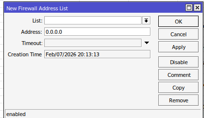

  • Should all subnets be added to IP → Firewall → Address Lists and then referenced from a single firewall rule?
  • Or is it possible to reference a file (for example a text file containing the subnets, uploaded under Files and accessed via the terminal) directly from a firewall or NAT rule?

So if I understand correctly, does that mean I will get 3,500 extra entries in the GUI overview of the Address List?
I can import it fairly easily in one go via the terminal, so if that is the method, then so be it.
Yep. I usually start my large lists' names with "zzz". :slight_smile:
