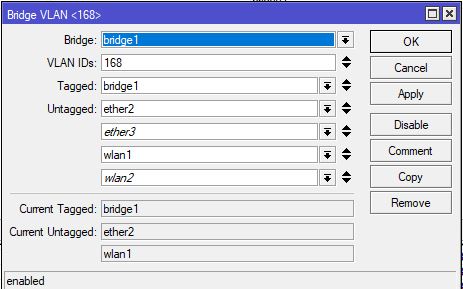

I think I understand VLANs on the 3xx switches but I´m missing an easy way to add a new port to VLANs. In the gui, I open the VLAN in the bridge menu and add the port(s). If there would be a few, no problem. But as we have many I would appreciate a faster way in the terminal.
When I export the config, replace the add with set and add the new interface(s) it would work. But should´n add do the trick?

You will use set when changing an existing line in vlan table, and add to add a new line in the vlan table
I know, but how would I add a single port to all VLANs without lots of exporting and editing?

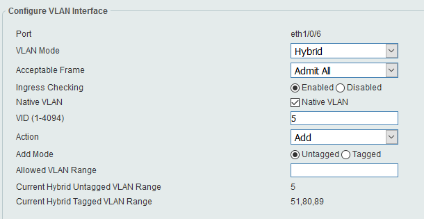

like on Cisco:
switchport trunk allowed vlan { add | all | except | remove } vlan-list
or on Dlink DGS-1510 there is an add or change option in the weg gui.

select port → add/remove/set VLANs per port
like Dlink:
under Action either add or remove the inserted VLAN from the list the port is currently in. Or replace the range complete. But on a per-port base.

you can do the same as per dlink with mikrotik gui
but in cli? not so
edit: add to a vlan yes but add vlan to a specific port?
To nitpick: can you do it on D-Link in CLI?
