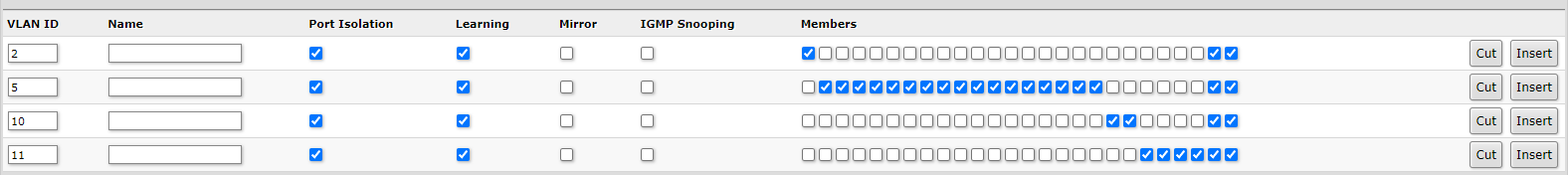

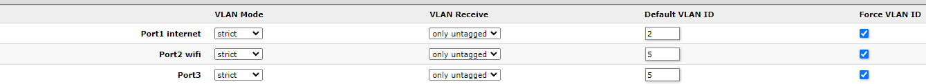

Link config (Port1 is currently not connected as I’m using internet through my other switch for now)
VLAN:
VLANs:
At first I tried this with routerOS, but had issues to get that setup, but if that is an better option, I would be happy to give that a try (I just didn’t really understand the Bridge /interface concept there and how that interacted with VLAN’s and addresses.)

I have a CSS106-5G-1S (the only type of MikroTik switch I have) and I have never used the “Force VLAN ID” option. In my opinion, it is an option that shouldn’t be used unless you are sure you understand what it does and why you would want to classify all traffic into a single VLAN, regardless of whether it was tagged or untagged when it was received. My understanding of what it does is similar to having a “bargain bin” with a sign, all items in this bin are $1 each regardless of any price labels.
If you look at the examples in the documentation, you will see they don’t use that option.
I’m largely with Buckeye on this. I do not have Force VLAN ID on any of my untagged port. I looked at a couple of my switches, and for untagged ports, I have VLN mode as Disabled, and VLAN Receive as Only Untagged. On trunk ports, they are set to Strict, Only tagged, and Default VLAN ID is a bogus number. Again, I do not Force VLAN ID.

After the input and doing some reading, I agree that the Force VLAN ID should not be selected. From what I could tell it applies the default VLAN id to all incoming packets (So I’m surprised - and concerned - that anything worked even for a bit when that was enabled)
I de-selected it and tested and it ran good… for a while… The very next morning, the same thing happened again. All the sudden internet stopped working Checked my firewall and WAN IP was cleared out again.

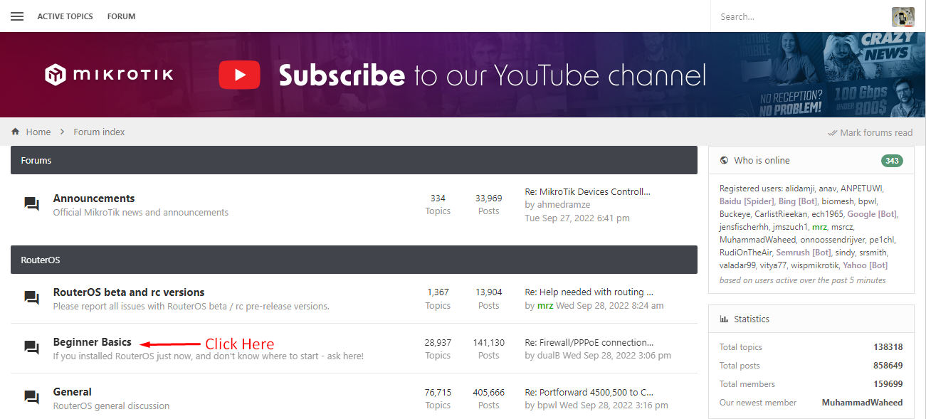

Since this thread is marked solved and your problem is not related to this thread, please open a new thread. If you think there is something in this thread that applies to your problem, put a link the the post that is related. But copy your post to a new thread, then delete the one here, and I will delete this post then.
How to open new thread??
On the list of forum topics, click the big green box that says “New Topic”
Here are pictures.
