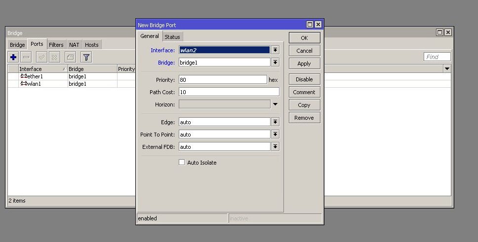

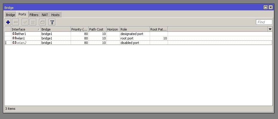

Then I activated wlan2 and tried to add it to the bridge1 ports, but wlan2 is printed italic in the dialog, see attached screens.
I tried adding despite being italic, and it shows as disabled and cannot be enabled:
WLAN2 will enable as soon as a client connects to it.
No clients connected → WLAN interface is disabled.

Or you can set disable-running-check=yes on wlan2 interface …
