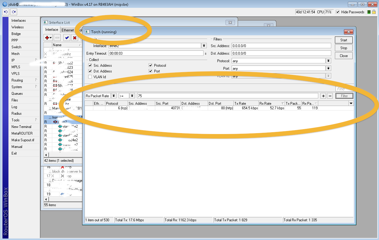

I have done this twice by accident and tried to bring this up again, but I can’t seem to figure it out! For example, in the picture there are a lot of ping’s going on. I would like to filter just the pings out (as in does not contain icmp) and see the remaining traffic in real time.
Here is a picture of what I’m after: http://img355.imageshack.us/img355/598/icanhasfiltersty5.png
I know it can be done as I have mistakenly done it twice. Thanks in advance!

What I’m trying to figure out was how I got the filter bar enabled for the torch window, just like it exists on the firewall window.
This will enable me to say hide traffic that is icmp and hide traffic that is udp and hide traffic that is gre but show anything and everything else.
As I said I have done it a few times by accident, but I wasn’t aware of what I had done to get it to show up!
yes, it’s obviously filter bar is show up, but I did it accidentally, and I don’t know how to reproduce it. Anyone know it?
Anyone know how to do this? Done it a few times by some kind of magic but it’s really handy!
Has anyone figured this out? I did it once and it is incredibly helpful but I can’t figure out how to do it again!!!
It magically showed up on one of my consoles! So I’m posting an image of what I want to be able to turn on and off at will.

Hit F on the keyboard to show this
Doesn’t work. at least in v5.5
you are right. strange
Doesn’t seem to work in 4.17 either. But I have been able to get it to come up I just can’t remember how I did it! I’ve tried every key sequence I can think of to no avail! Any chance we can get that option put in the code??
we checked the code, and it says to press F :slight_smile:
ok, will check again
Ha. Yea, F doesn’t work. :slight_smile:
