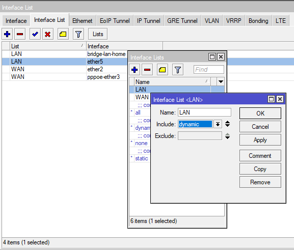

May i know why you wanted this ?, because from my perspective from the interface lists you can add / include dynamic interface list, dynamic includes all pppoe-clients.
I found this when I tried to find a solution to possibly put my openvpn ppp interfaces into the LAN list for some firewall rules to apply correctly.
I now implemented to include “dynamic” into the LAN list but I’m wondering what other interfaces may be dynamic which maybe shouldn’t treated as LAN/internal.
At this moment I don’t have any (if D is the flag indicating that in the interface list).
A script is not needed, you can specify an interface list in the PPP profile used by the PPPoE server - the dynamic interface created when the PPPoE client connects it is added to the list specified automatically, and removed when the client disconnects.
