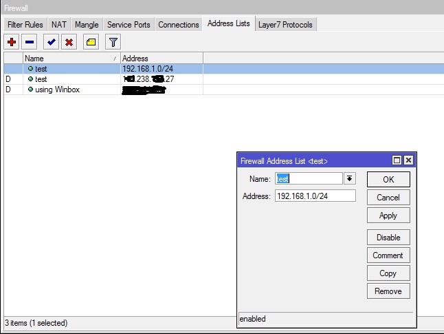

It works :
Thank you, sadeghrafie.
That shows, very nicely, that the mangle rule adds entries for ips not covered by the /24.
Did you try any traffic from hosts which are covered by the /24?
Yes I try it. It doesn’t add the addresses which covered with the /xx subnet. But the point is when ever I disable that address list (/xx ), the single IP address will add to address list.
It means the mangle rule check active address lists and see whether the certain IP address is in the list or not then add that IP.
well, behaviour is correct: if new address is already covered by address-list, then it won’t be added :slight_smile:
