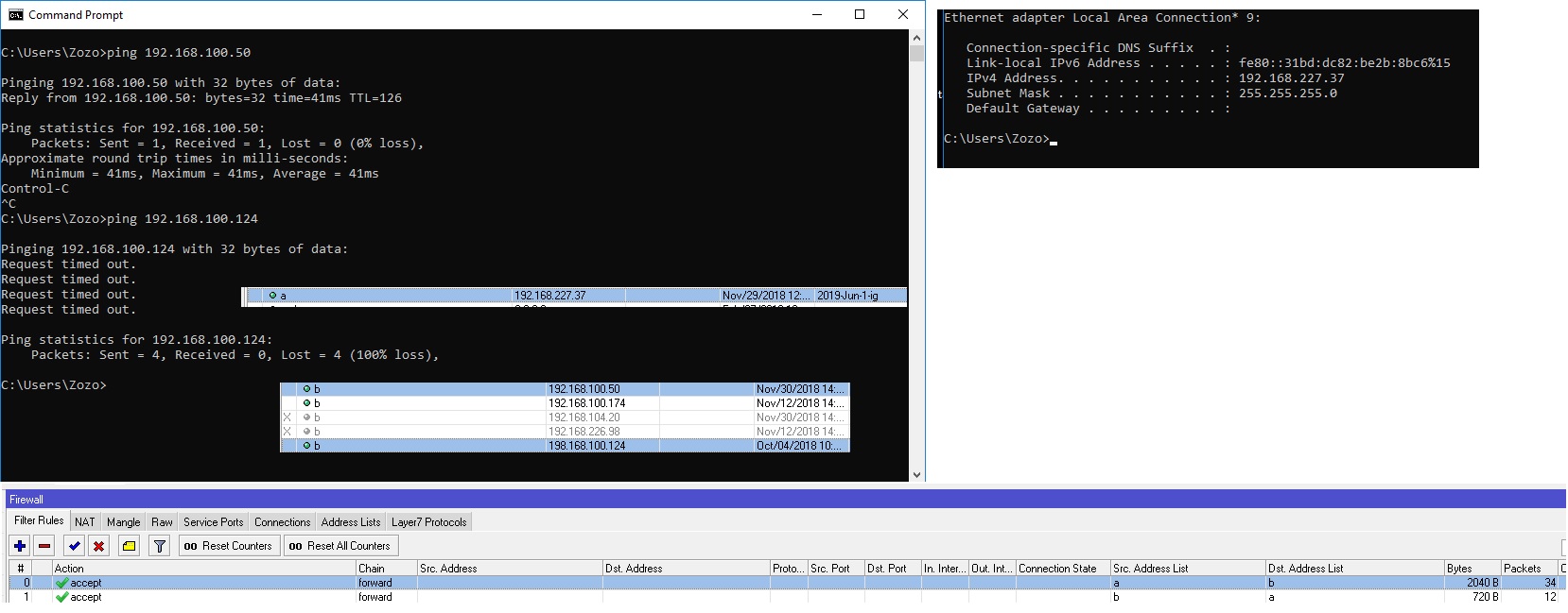

https://forum.mikrotik.com/download/file.php?mode=view&id=34617
Does the first packet counter (34) increment if you ping 192.168.100.124? And the second packet counter (12)?

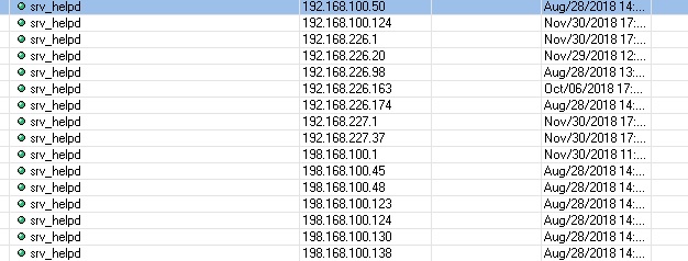

In my case this was the situation: https://forum.mikrotik.com/download/file.php?mode=view&id=34618
So i could reach 100.50 and 100.124 but i was not able to reach 100.1 100.45 100.48 and so on…
If i put them before the 226.1 then… tadaaam its working.
I would be interested what kind of shitty algorythm is doing this… SO I report this BUG, or shall i call it a feature?? :slight_smile:.
